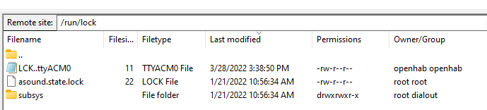

Only random suggestion at this point, as I do not have your setup, and this may not be an issue, but since the focus is on permissions, there have been forum posts over the years about the LCK file needing to be with openhab owner.

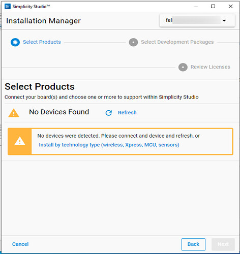

I installed Simplicity Studio (into a Windows Virtualbox VM) yesterday – but guess what? Stick not recognized by the app. [ Meanwhile, Windows “dings” when it is inserted AND device manager shows it as available on COM8! ]

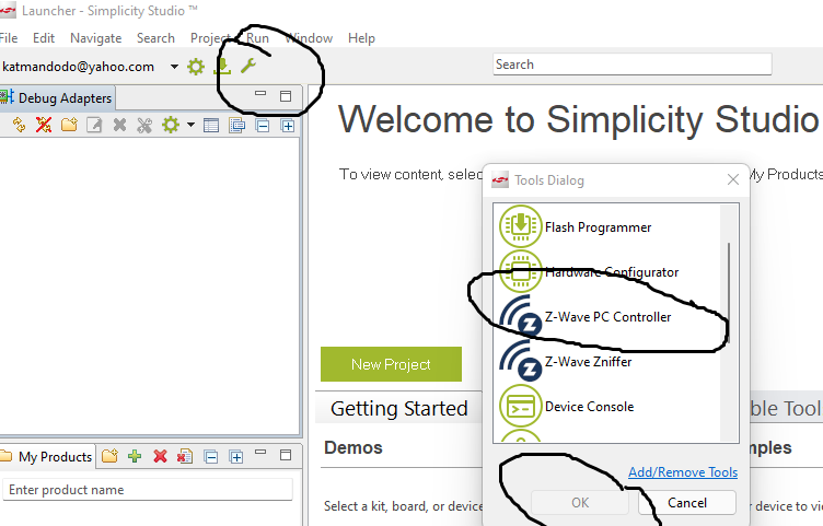

Take a look at my “result” in Simplicity Studio when I tried to recognize the stick in order to install the “PC Controller” plugin . . .
The hardware is fine which is good.

Your screen shot doesn’t look right, but I’m not an expert on the program. It has been awhile, but I do not recall having to add the tools. This is what I get when I open Simplicity Studio.

My screen shot comes AFTER asking Simplicity Studio to install plugins. At the bottom of your “tools” screenshot you will notice “Add/Remove Tools” I have the same window, but it is empty . . . at which point I try to add tools, leading to the screenshot I posted.

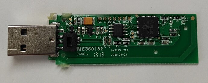

A moment ago I took apart the Zooz stick. Here’s a closeup of the physical device, perhaps it will give someone an idea as to whether it is indeed a Zooz device or an Aeotec one . . .
I think both. The zooz-z-wave-plus-s2-rgbw-dimmer-for-led-strips is built by fibaro and is basically same as Fibaro rgbw 2.
you can see they do not hide it even on the product photo ZOOZ ZEN31 RGBW DIMMER – ZOOZ
I just ran lsusb on my server, and my Zooz S2 also reports as an Aeotec.
Bus 001 Device 004: ID 0658:0200 Sigma Designs, Inc. Aeotec Z-Stick Gen5 (ZW090) - UZB

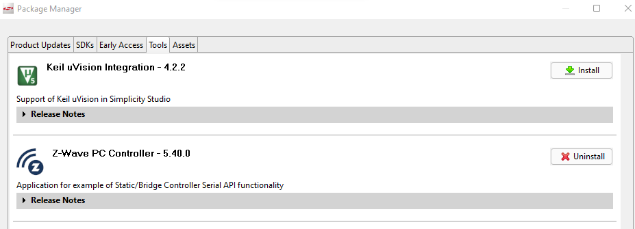

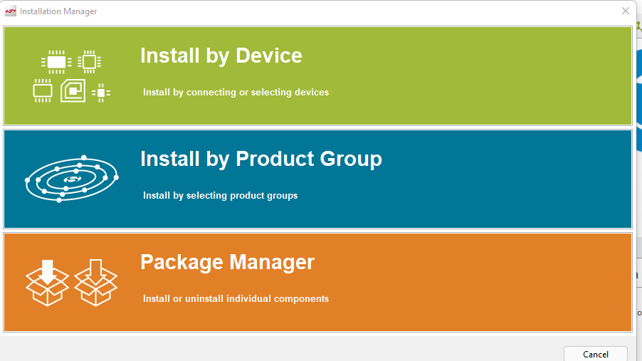

So I hit the add/remove tools and get
Then I hit package manager & navigate to the tools tab
Are you signed in? All this is without the controller being plugged into the pc.

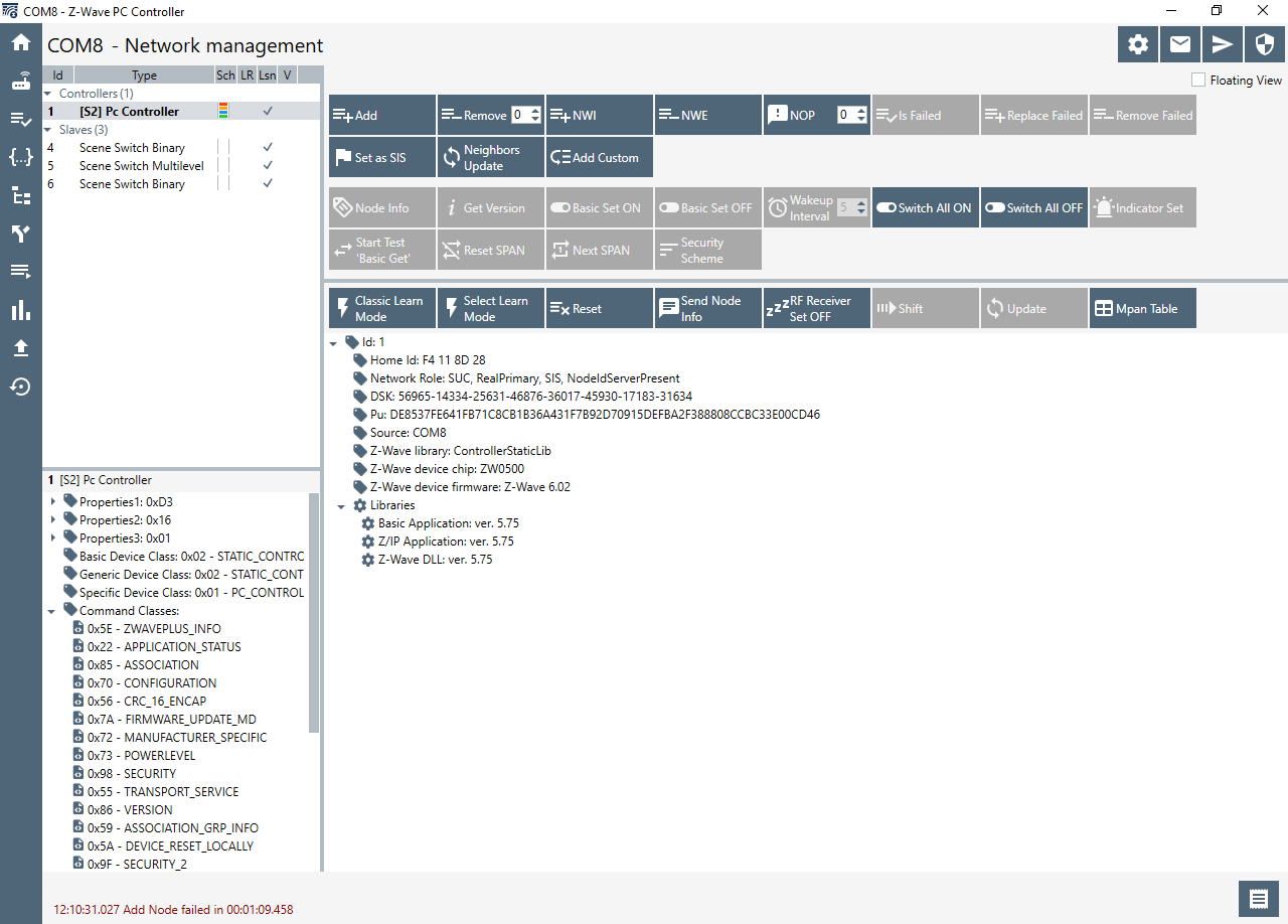

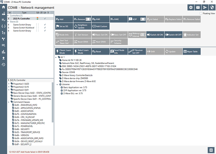

It turns out Zooz sent me the (standalone) “PC Controller” package by e-mail right before lunch. I ran that completely independently of Simplicity Studio and while the PC Controller software is able to run, it was not able to update the firmware as I got blocked at step 6 of Zooz’s firmware update instructions – the device can not get “added” in they way they suggest.
See attached screenshot
After lunch I removed, reset, etc. everything I could between the slaves and the controller (let’s hope that doesn’t turn out to have been a bad decision! :crazy_face: )
Now I seem to be able to do even less with the provided “PC Controller” software (including “re”-adding the Zooz stick)

BTW: yes, I was logged in to Simplicity Studio, but I had the stick plugged in. Perhaps that is why I did not see the package manager (I had only device and product group options).
BTW#2: your Simplicity Studio looks quite different than mine. Looks like you are running on Linux (I am/was on Win 10 in a VM as they – Zooz et al – seem to prefer that. Only Ubuntu is “supported” in Linux and I am mostly working on new Fedora installs here. I don’t want them to claim it is not working because of platform issues.
