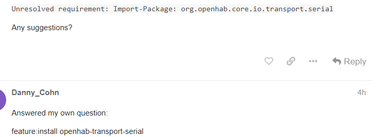

One last idea from my side, Felix: Do you use the ZWave binding that comes with the OH installation or is it a snapshot you installed yourself? If it is the latter, the standard ZWave binding should be removed/uninstalled and in some cases the serial binding needs to be installed so that the ZWAVE binding can talk to the port representing the controller.
That is an interesting observation.
Do you think adding the serial binding might fix any missing dependencies that are lacking in some platforms? It is certainly not going to do anything harmful.
Installing bindings via GUI takes care of dependencies like this. It is only necessary to look at it when bundles are installed manually via dropping them into the addon folder. In this case the dependencies need to be taken care of by the user. Usually there should be an error message of some kind if something is missing. It’s been a long time ago that I ran into such a situation, so I cannot tell if a helpful message will occur in this case, I did not test it with OH 3.2.

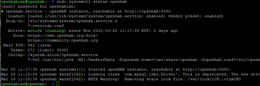

Did you ever try the LCK file permissions either from my post or the second solution in the thread @robmac posted? Or run OH as root as @mhilbush suggested?
Here’s a short story. I create a modified zwave binding for a variety of reasons (unimportant here). I recently tried a shortcut and controller would not start :frowning_face: I restarted OH and everything came back :smiley: Interesting in relation to this thread is this;
note the removal of the LCK file
Also info level logging for this same restart showed this ;
Zwavestart
Note the time of the stale lock removal and the first INFO (controller is null).

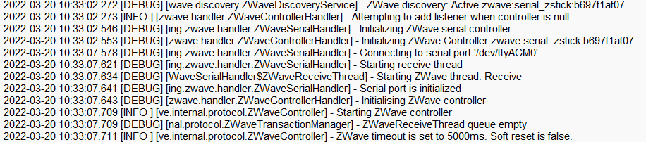

Lastly I found an earlier Debug log level start-up
The debug you posted above is identical but doesn’t connect to the serial port. Since all the other permissions seem in place, it seems like the LCK file or something specific to the serial port. Maybe that will narrow down your search.
On the serial binding there is an obvious error message (unfortunately I run across this when I get sloppy). I found a recent post showing the message and solution.
I do not think that is an issue here because you would have noticed.

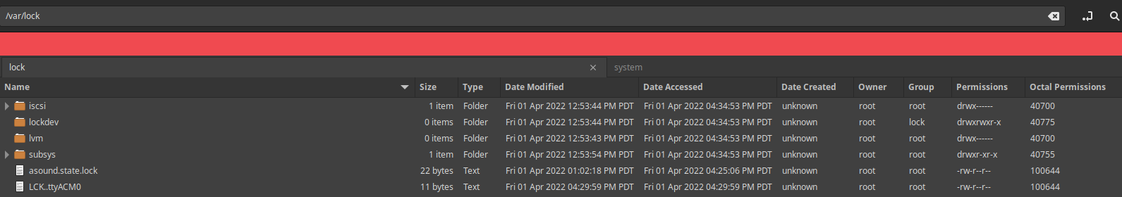

Indeed, there is no relevant file at /run/lock
please stand by a few moments while I figure out how to start openHAB manually
I believe it is linked via /var/lock. Try that.
That message in karat seems to point that way. Edit: I mean this

Oh my,
should have read
My apoligies for this misleading advice. The serial BINDING has (as far as I know) nothing to to with the communication between the ZWave binding and the port the controller is represented by on OS level.
This is just one of many differences between the various Linux distributions. In this case between my RasPi OS and your Fedora. Obviosly they handle some security aspects in a different way.
Now I see, you found out what blocked your success. Good to see that and I try to remember that as a possiblee obstacle for non openhabian users.
@FBachofner Glad you got to root (no pun intended) cause. :wink:
But, wow, that nrjavaserial issue referred to by @wborn in the GitHub issue is really nasty. Six years and still not solved. :sob: Not sure what the path forward will be from here.
I guess it also explains why Ubuntu works fine (for now), but I fear it just might be a matter of time before Ubuntu breaks, too.
Can I ask a question? Did this issue get resolved? Was it a problem with nrjavaserial and the file lock bug?
