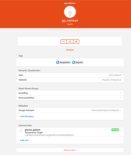

I would ask for help with configuration thermostat working on zigbee2mqtt with Google Assistant. When I say: “Hey Google, set thermostat to 24 Celsius degrees” it answers: "Sorry thermostat doesn’t support choosen mode. I had configured thermostat thing in UI (enclose configuration) and I created group in items file like this
Group thermostatOffice { ga="Thermostat" [ modes="off=OFF:WINDOW_OPEN,heat=COMFORT:BOOST,eco=ECO,on=ON,auto", thermostatTemperatureRange="10,30", useFahrenheit=false ] }
I added to this group item gg_nastawa:
Configuration thermostat Thing:
