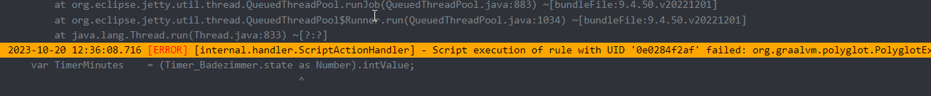

plusMinutes() expects a long Value, not an Item.
I don’t use JavaScript, but at least I would expect something like
ZonedDateTime = Java.type("java.time.ZonedDateTime");
var TimerMinutes = (items["Timer_Badezimmer"].getState as Number).intValue;
this.timer = ScriptExecution.createTimer(ZonedDateTime.now().plusMinutes(TimerMinutes), turnOff);

Your hint doesn’t solve the problem, looks like as was remarked as wrong. I’m also no a Java guy so I have no clue what I can do that it works again. I’m not sure if it is a Java problem or a change in the definition of the items in OH4.
the item itself is defined as type number.
