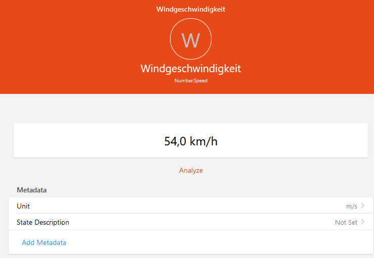

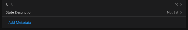

If not setting the double quotes, you can’t set the child parameters (at least this was true for OH3.x) via text file. And of course you can see it in the metadata listing (here: Not Set)
Well, at least for now you have to set the empty string when configuring the stateDescription pattern (openHAB states an error when not using the quotes).

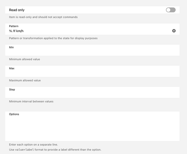

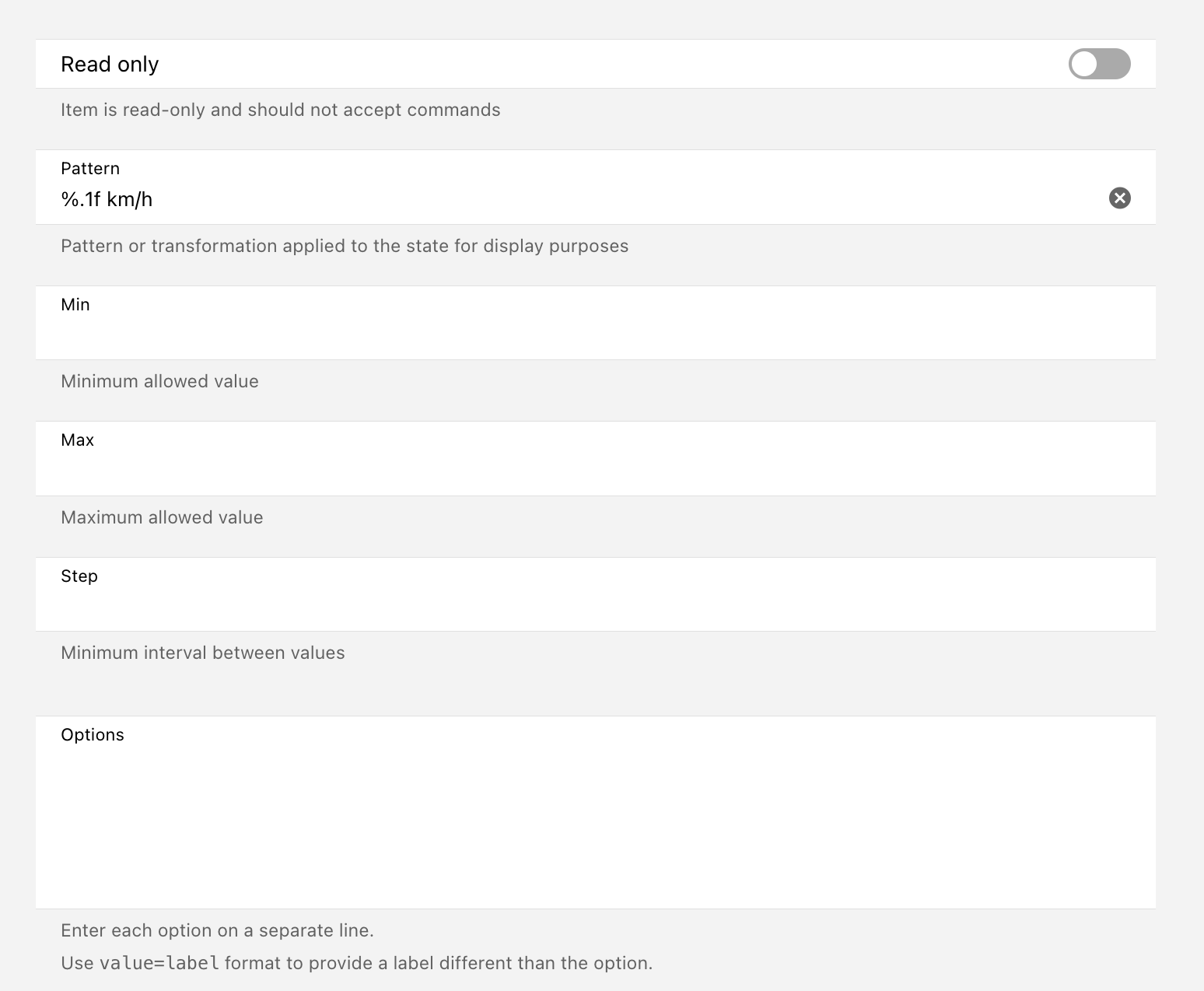

It’s really weird. I also tried setting this through the UI, creating a new Item of type Number:Speed, but as soon as I connect it with the proper channel, the value changes to UNDEF, no matter whether a state description is even present. Maybe something is wrong with my particular Version of OH. I am using version 4.0.1.
