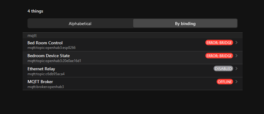

I have established broker connection with openhab using UI interface provided with openhab3. But after few minutes it tells me its offline. Once its offline, i need to go to the mosquitto broker terminal and need to press any button (input), than only above connection of broker to openhab gets online (that too for few minutes).
Prob: Connection is offline

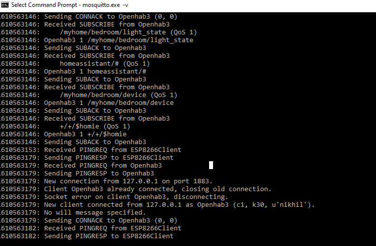

My Moquitto broker terminal:

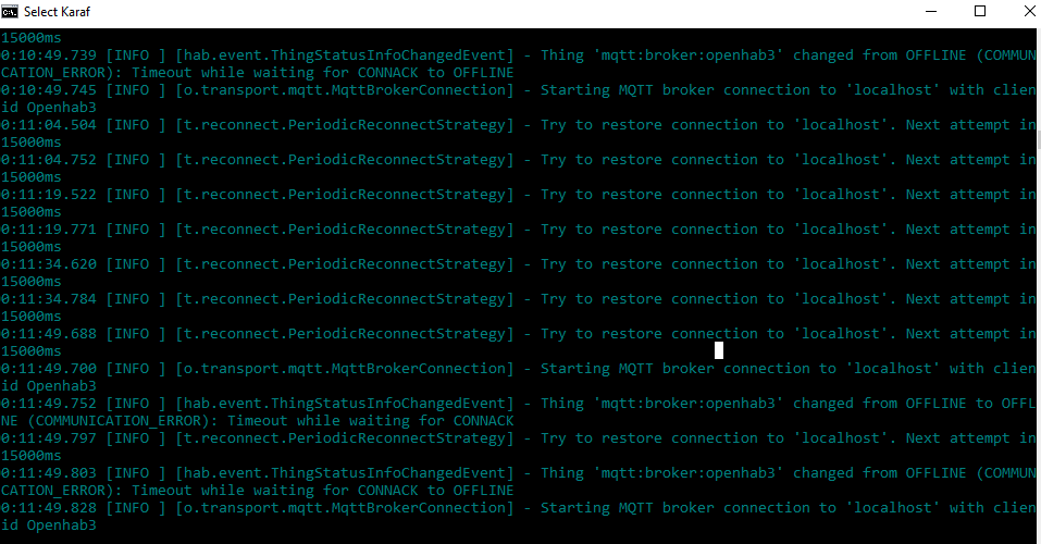

My Openhab terminal:

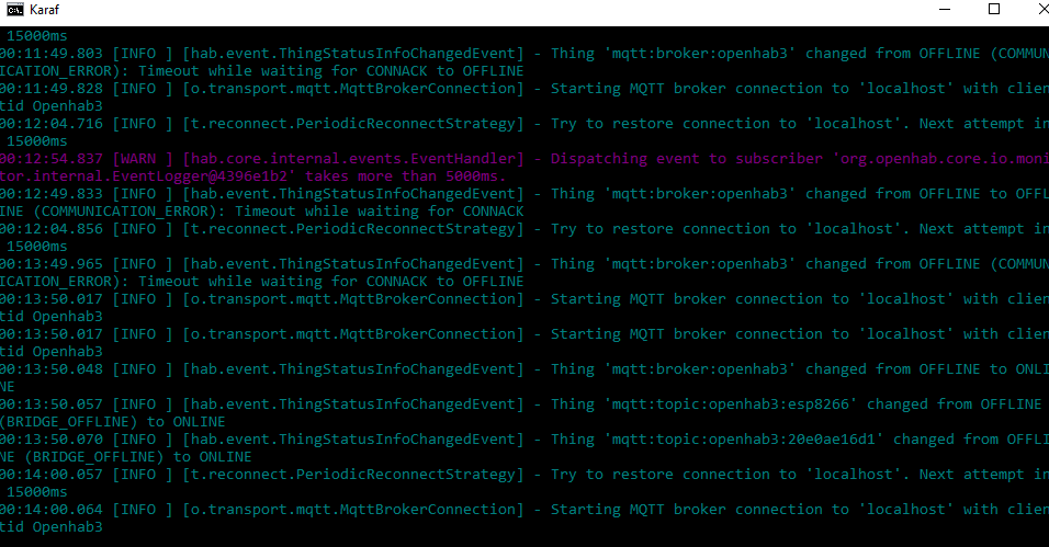

Now when i get this issue, I press enter in the mosquitto broker running terminal and the connection between Openhab and broker comes Online.

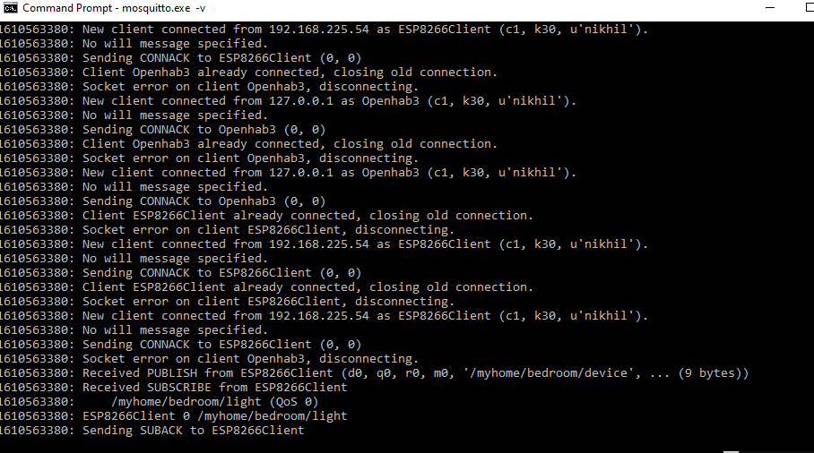

Broker Terminal:
Openhab3 Terminal:
