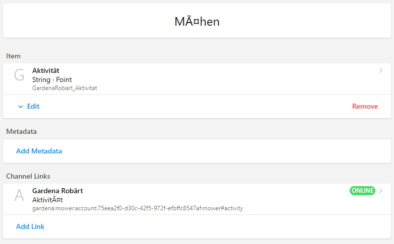

Using the current build I have problems with german “umlaute”. This is a screenshot of my activity item of the mower. Do I have to change something in my configuration?

Wow, It solved the problem. Thank you!

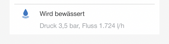

is it possible to retrieve the flow rate and water pressure for Gardena pump “smart Hauswasserwerk 5000/5” while the pump is active?
I cannot find a channel containing this data, but it is available in the Gardena App as in the picture:
