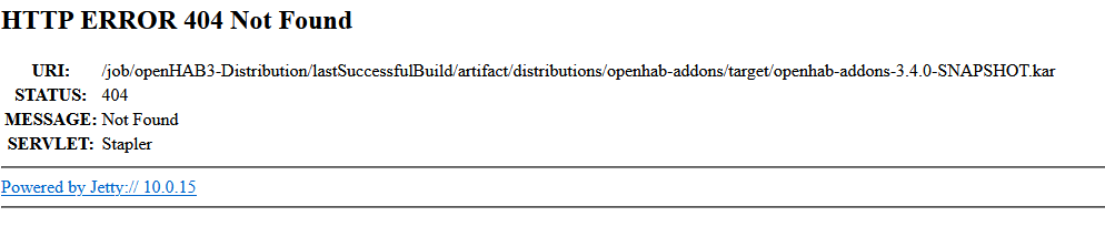

  1. I’m still unable to connect to the devolopper portal. I’m glad I found this thread and it looks like the new .jar file gerrieg created and openschwall published should solve the isse.
    Unforturnatley the link openschwall shared does not function anymore so I can’t download the file.
Can somebody pls help me to get access the the updated .jar file.
