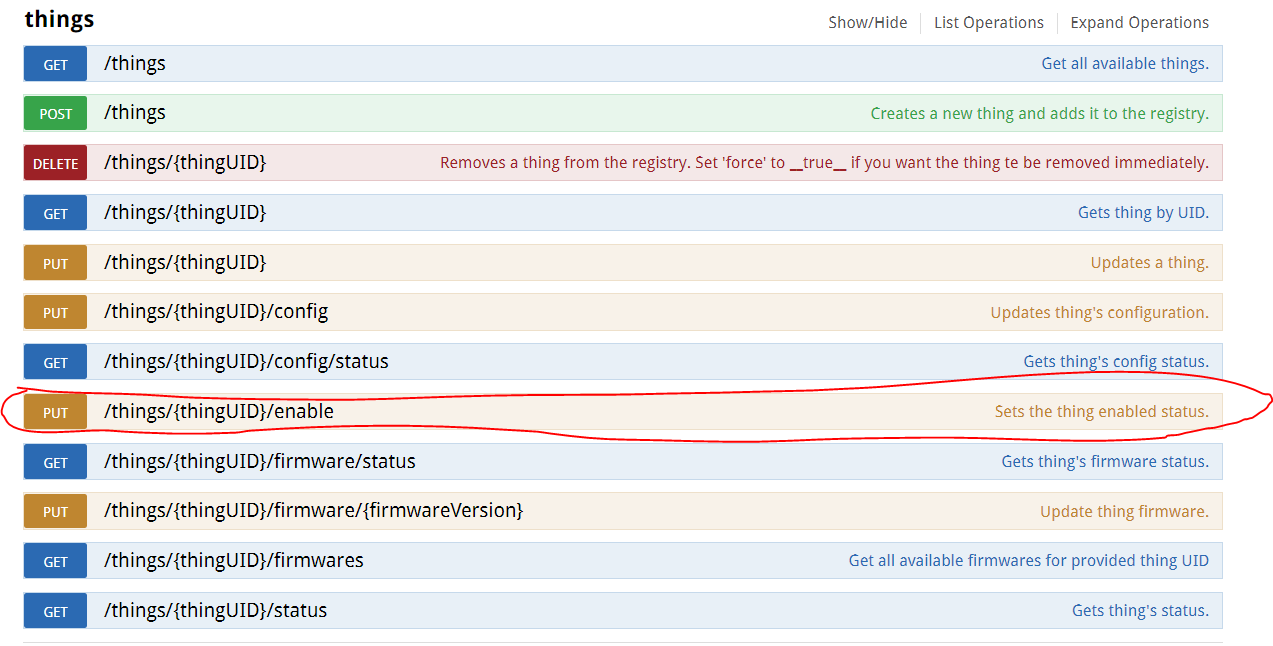

If you can detect the failure (e.g. with network binding) you should be able to use REST API to disable the Amazon Thing (the account thing perhaps?) and stop it complaining.

Could you provide the technical framework for this concept? Maybe use one of my bindings below that maybe you have an example (network, amazon, open weather, ring, sonos, nest, dark sky, air quality, unifi and ip camera)?
Open that up and experiment. This will give you the HTTP calls you need to make to enable/disable the Thing which you can implement using the sendHttpPutRequest Action from a Rule.
I am on openhab 3.2 and this is still a problem. Log fills up when the internet becomes unavailable. I would like the binding to recognise that situation and make the error in the log simple and plain instead of verbose and difficult to work out what happened. I did ask the devloper a while ago but he wasn’t supportive at the time.
So, I wrote a rule and some scripts that monitor the network access to the internet and when the internet is unreachable a script runs that stops the binding (uses karaf) or disable the the amazon echo account thing (uses REST api). When the network is back the rule enables the thing or restarts the binding. Enabling,disabling the thing is the preferred method as I found sometimes restarting the binding didn’t always work in OH2. I have the monitoring now also running in OH3
