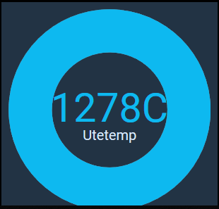

Habpanel

That should be about right. What does not work exactly?
In this case it still shows the same value just that it removed the “%”.
Was thinking that it was ignoring the :transformation=JS(devideTemp.js)" part of it
bilde
The presentation is about what you put in the Item’s label, you took out the part telling it to display C
Try
Number  V3601Utetemp "Temperatur utetemp [%.2f °C]" ....
That’s where you first had your transform, it altered the display value but not the Item actual value.
Applying the transform to the modbus binding instead will work on the number before it gets put into the Item,
I would guess your transform is actually failing - should be able to see that in your log? - because the transform is trying to put a string with a comma and ‘°C’ into a purely Number Item.
You need to change your transform so it that just does the numeric part.
