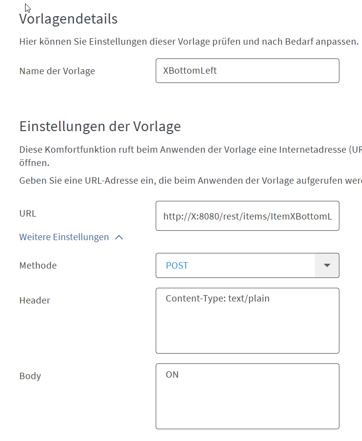

Then I created a script to call a website when a botton is clicked. The name of the Website is:
http://X:8080/rest/items/ItemXBottomLeftPressed
These are the settings:
I hope this will help others to integrate theirs.
