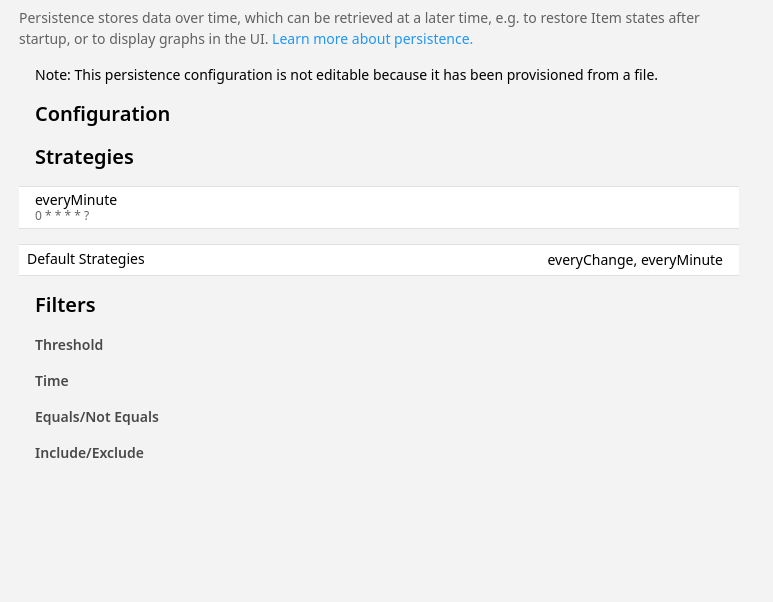

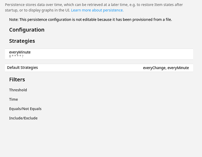

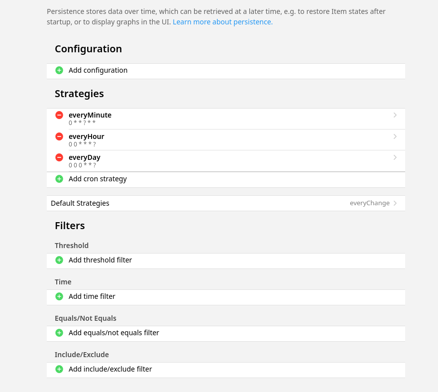

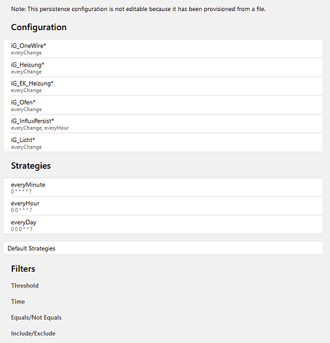

Hey guys,
I have a strange problem… I was migrating to influxdb2 as persistence service instead of rrd4j. It also worked in the beginning, but after a while, no data is saved anymore in the influxdb2 bucket. I have already reinstalled completely influxdb and also resetted persistance settings on openhab, including removal of the addon, deleting the file /var/lib/openhab/config/org/openhab/influxdb.config and also cleaning cache and restarting service for openhab. Without success, now that I reinstalled influxdb I don’t even get 1 data into the db. Does someone where I can find more hints on the problem?
If you need more info or logs, please tell me what you need and I will provide it to you.
Patrick

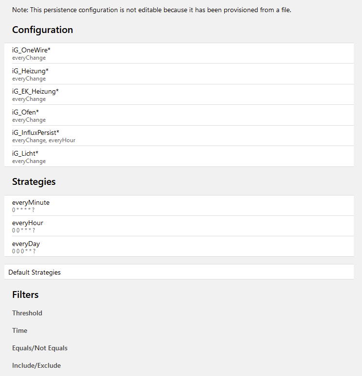

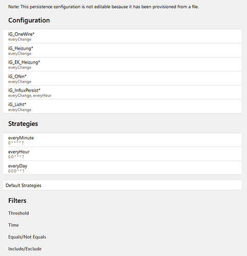

I managed now to make it work again by removing persistence settings in mainui unter influxdb addon settings. But I have one problem… I want to save data at least every minute additional to on every change. Does someone managed to get it working with influxbd, as when I am setting something in persistence settings for influxdb, nothing works again, until i remove it.
Just turn on DEBUG and let everyone to see what is going on. My personal experience is mostly related to InfluxDB credentials.

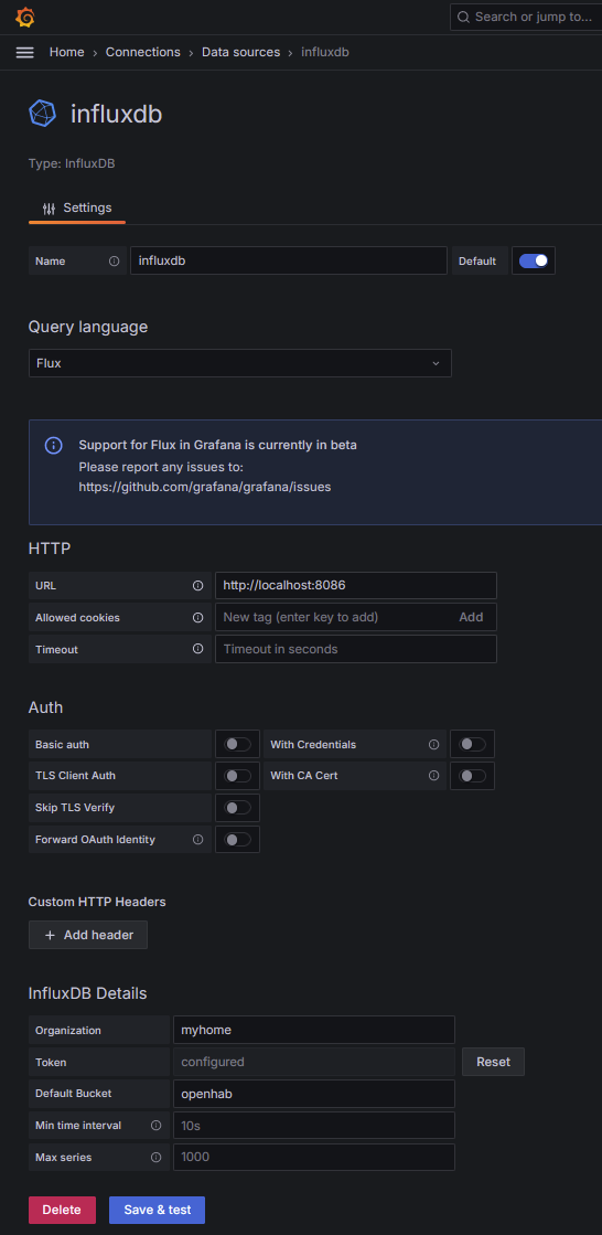

I don’t think that it is a problem with creds, how I already wrote in the second post here, the problem with not writing at all I resolved by myself, but it remains the problem, that if I am editing the persistence settings via main ui, in influxdb to “Default Strategies” minutly additional to everyChange, then the data will not be saved to db. If I leave it as it is per default it is working and saving all the data in db, but only if a value changes. I want to have also at least every minute a value stored to db.
Here are the logs from a start of openhab with created file /etc/openhab/persistence/influxdb.persist:

and to complete in grafana my datasource is configured as follows:
as i wrote my dashboards i had to create new, the query now looks like
from(bucket: "openhab")
  |> range(start: v.timeRangeStart)
  |> filter(fn: (r) => r._measurement == "iSl_pac" or
                       r._measurement == "iSl_yieldday")
  |> aggregateWindow(every: 15m, fn: mean)
(for two items iSl_pac and iSl_yieldday)

the persictence i did not setup in main ui but in file /etc/openhab/persistence/influxdb.persist this looks like:
Strategies {
    everyMinute : "0 * * * * ?"
    everyHour   : "0 0 * * * ?"
    everyDay    : "0 0 0 * * ?"
Items {
    iG_...
but in main ui it is showed as (not editable):
… as you see i configured everyminute but i do not use it in none of my items

I have to say, that I really don’t understand what I am doing wrong. All the settings seem correct, and also the functionality of influxdb is here until i get at the point where:
  • I am saving the persistence settings in the main ui,
  • or generating a file /etc/openhab/persistence/influxdb.persist with the following contents
Strategies {
	default = everyChange, everyMinute

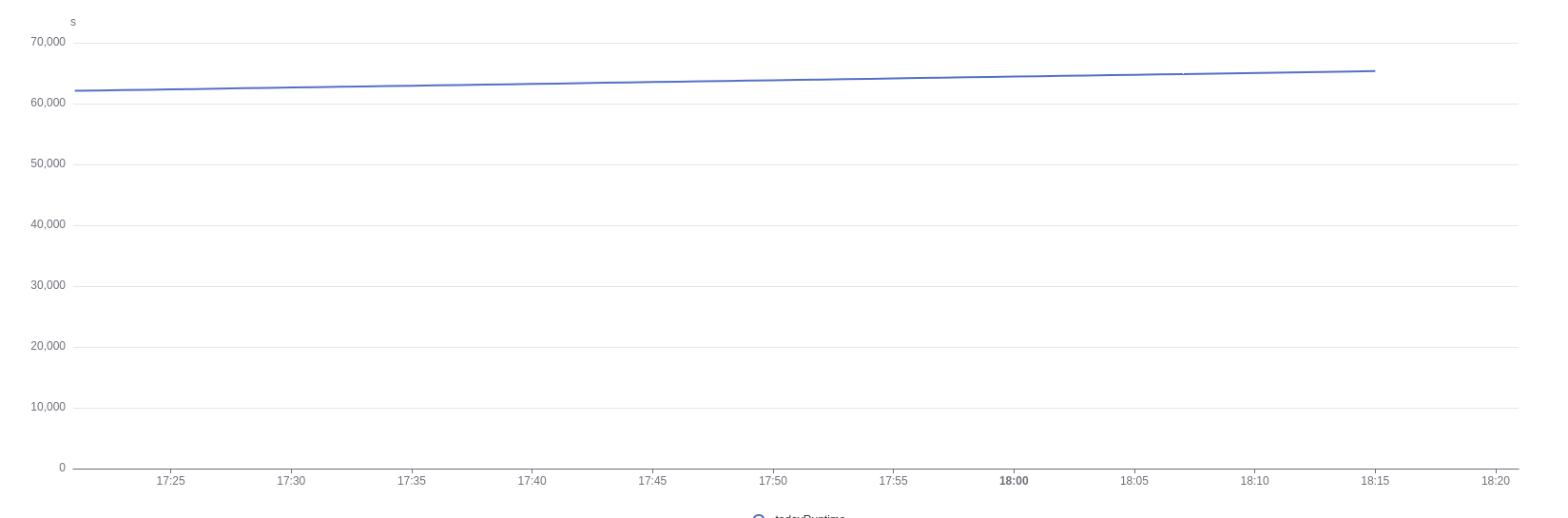

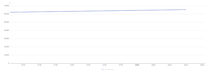

after that the persistence is not working anymore. When saving via main ui immediately when I press save, and when I am creating the file, obviously after the nex restart of the service, when the file is loaded. No new data is saved anymore in database, neither in bucket openhab as specified by me, nor in the bucket autogen, which I created for testing purposes to see if there is saved data in.
If I leave the persistence settings here as they are, no problem (in the screenshot I was making a test with the file, so they are edited, by default there are defined some time expressions and as default persistence there is only everyChange):
But after the file loading or saving it directly via the main ui, without creating a static config file at /etc/openhab/persistence the service is not working anymore, as seen here in the screenshot:
There is missing data since 18:15, that is the time I restarted the service to load the file described earlier.
You are missing the Configuration section. That’s where you define what items get stored, and with which strategy.
By default, if no persistance configuration and/or strategies are defined, all will be stored at the default strategy. As soon as you configure something, the default does not apply anymore. That’s why, when you define something in a file or the UI, nothing is stored anymore by lack of Configuration.
Where am I missing the configuration section? I want EVERY item to be stored by the Default Strategies everyChange and everyMinute, and as far as i know this should be the exact configuration for this. Or am I wrong?
So i have to specify every single item in the Configuration section to have it stored?
