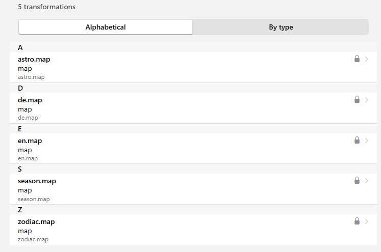

I installed the “Map Transformation” Add-On… and now?
still no effect!?
Please post your item config which makes use of this map transformation service

Did you restart openHAB ?
Still seeing the error in the logs ?
Not sure about textual, but using the UI it is MAP:xxxxxx.map?
This syntax works for sitemaps and does not work for MainUI (I might be mistaken though).
For MainUI pages/widgets you need to add a map profile
String Astro_Sternzeichen { channel="astro:sun:K28:zodiac#sign"[profile="transform:MAP", function="zodiac.map"]}
Also make sure that permissions of .map files are properly set. There is a „fix permission“ menu in openhabian-config.
