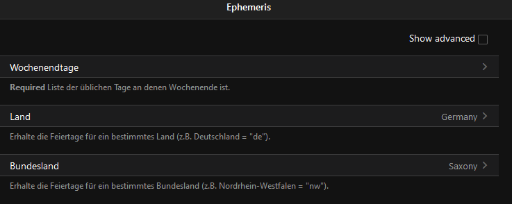

I thought I had the same problem but …
looking to the settings area I detected that I did not set my region in the ephemeris part.
So go to settings and set your country and region.
Then ephemeris will work for Reformation Day, too.
Holidays are defined in jollyday/src/main/resources/holidays/Holidays_de.xml at master · svendiedrichsen/jollyday · GitHub which is the base for the ephemeris service.
Here is the correct configuration screenshot:
I think that’s the correct configration.
