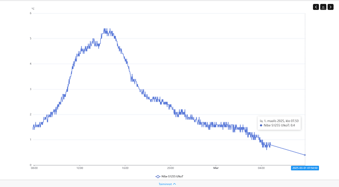

I’m running OH4.3 under Win11 Intel NUC. After upgrading OH4.3.0 to 4.3.3 I have had strange problems with rrdj4 as it seems to lag behind. Below you can find few screen copies.
It looks like that the outdoor temperatures between time period 4:48-7:50 missing. Below is another screen copy for outdoor temperature which shows that the values in that time range are OK so no values are missing.
Same problem occurs with all my items.
Rebooting the OH4 PC doesn’t cure the problem. There are no error messages in the log (log setting=Info). I didn’t have this problem under 4.3.0 and I have never seem this kind of problem earlier.

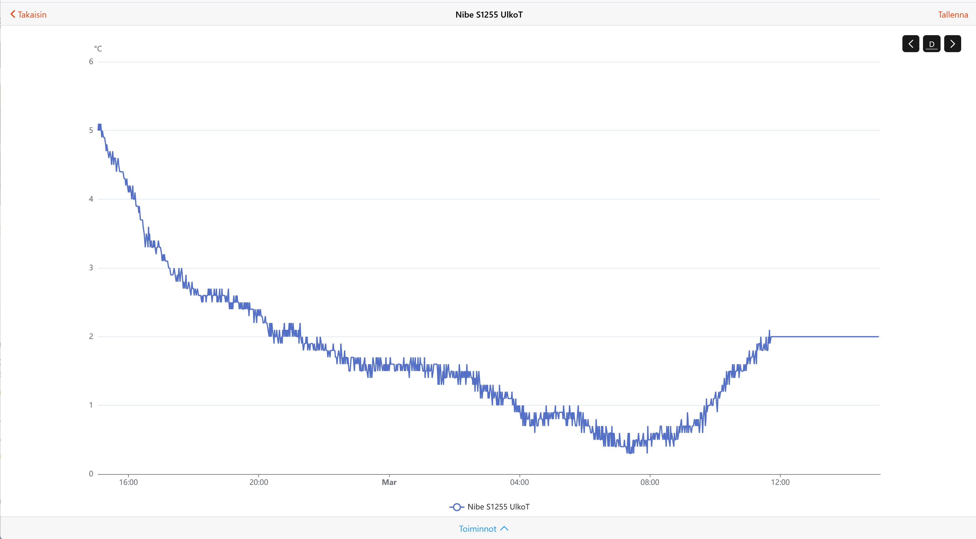

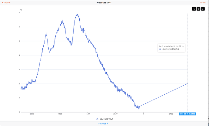

My problem with rrdj4 continues and now the delay is even longer, over 5 hours. Below is shown the outdoor temperature. I haven’t restarted OH4.3.3 at all. Any ideas?
This problem is getting really annoying. Now the delay is more than 6 hours (see the attached screencopies).
I restarted OH4.3.3 and it seems that the datapoints in the plot are completely missing so it seems that rrdj4 is not working properly in my case…
