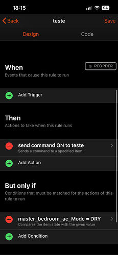

He everyone, I think I need a hand Im a bit confused because I could swear that this isn’t how it’s supposed to work. I’ve upgraded to 5.0.1 and i have the most basic of rules with one condition which I start manually :
Switch turns ON, but only when the air con is in DRY mode.
That’s it. This is just a test because one of my rules started misbehaving and I started troubleshooting. I’ve tried with numbers, switches etc and from what I can see the conditions aren’t being respected.
I also tried going with dsl rules but whatever I put in the condition filled is not being respected from what I can see.
I even created dummy items, created rules to set items to the needed states but… nothing
Manually running the rule from the UI buttons always ignores the conditions. I believe the rule conditions are only checked if 1) the rule is trigger by one of the rule’s triggers or 2) the rule is triggered from a some other script using the rule manager and the condition boolean is set.
This usage, where you want to trigger it manually and still have a check, should probably be done with a simple script action instead of the basic item action. otherwise, you’d need two rules. One rule which you trigger manually that then uses the rule action to call the second rule (you can set the check the condition boolean in the run rule action).

I and I did test with a cron trigger every 1 second and 3 simple switch items with conditions of if one switch was off and one switch on as defined in the conditions it only triggers the 3rd switch to on and it does evaluate and only trigger the action if both are in the correct state. However, as you also pointed out if you manually play the rule it does send the command to the 3rd switch and ignores the conditions.
