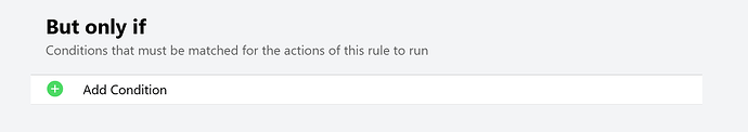

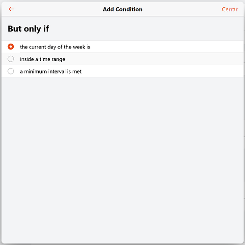

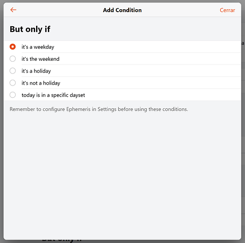

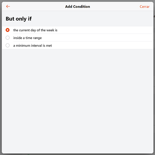

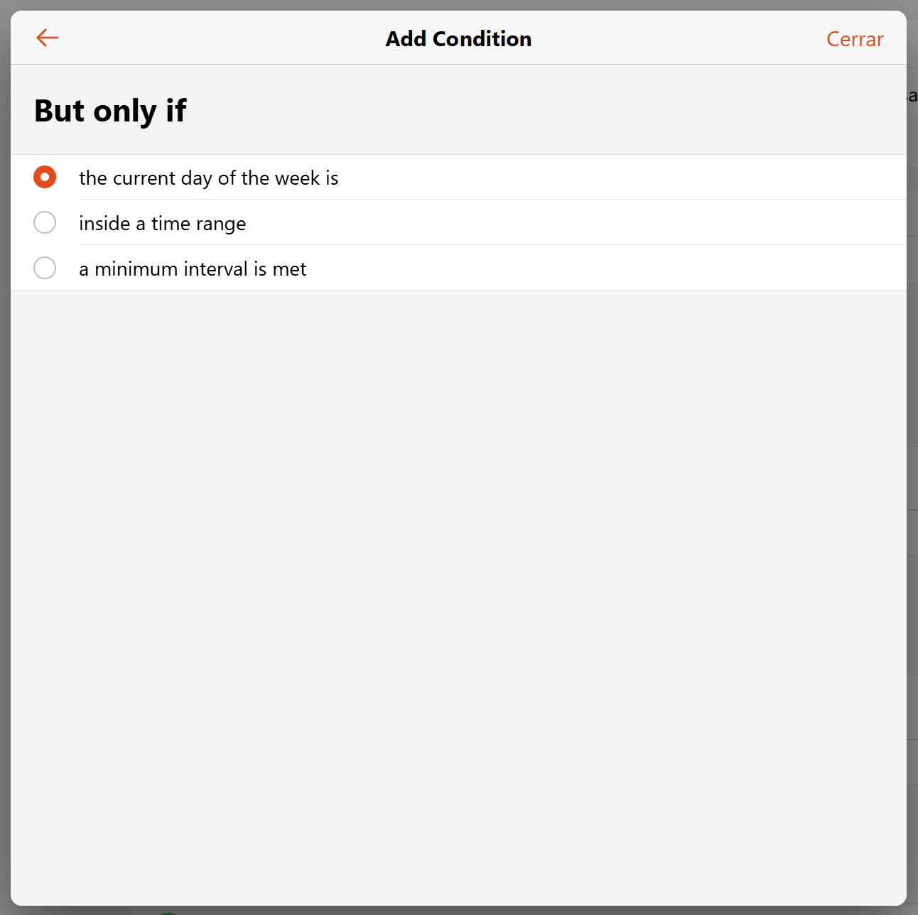

The main problem is that I can’t manage to set any kind of condition, either it is an Item, time, script or ephemeris type. I always got no options as values to set the conditions, like this:
I was usin OpenHAB 4.3 and upgraded last week to 5.1.0.SNAPSHOT to solve a problem with Amazon Echo Control loging to Alexa server. After upgrading I noticed about this problem, so I thought it was related with snapshot version, and I upgraded again to 5.1.0.M2 getting again the same problem. Yesterday I upgraded
to 5.1.0.M3 to get this very interesting performance of Z-WAVE JS binding getting node numbers higher than 256, but unfortunately I keep on experincing the same problem with rule generator.
Thank you in advance for your help
Diego

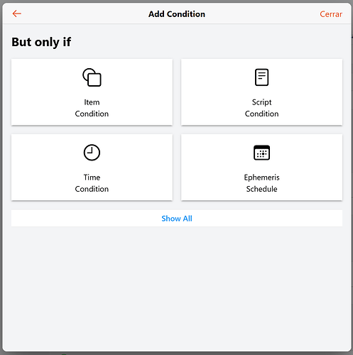

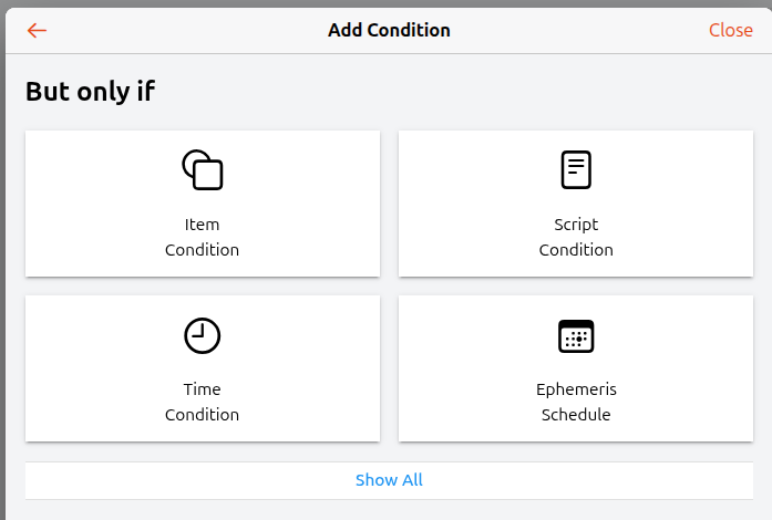

I think we need more details.

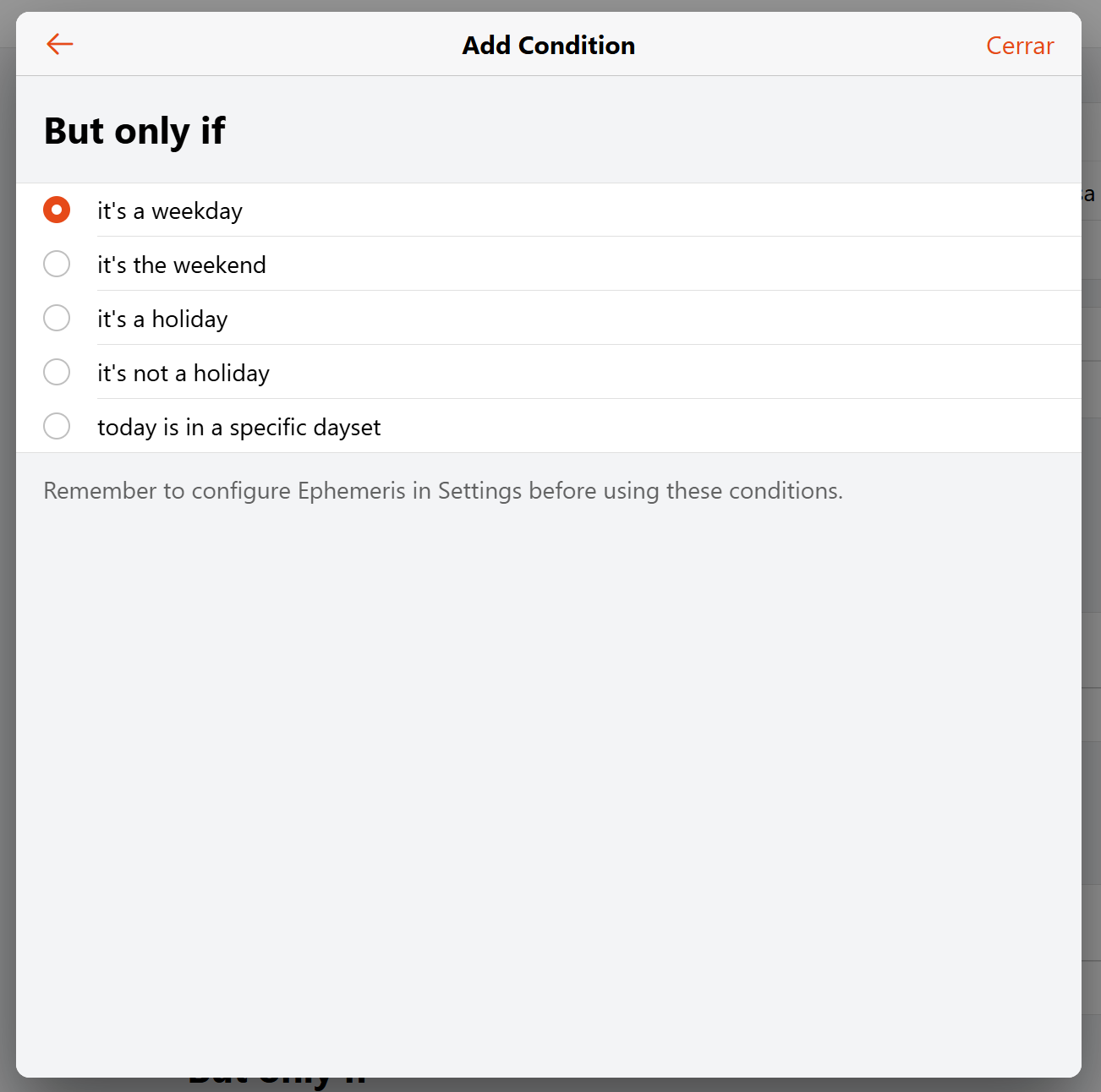

When you click “Add Condition” do you see the four categories or does it jump straight to these time based conditions?
I too am seeing a problem with the time conditions. This might be related to the big migration to Vue 3. An issue should be filed on that. It’s also not working for Ephemeris.
However, for me Items are working as expected.
After selecting the Item I see the form as expected.
Script Conditions are working as expected too.

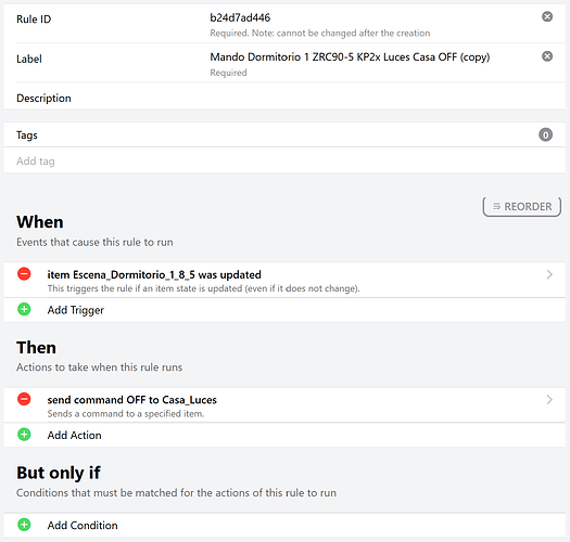

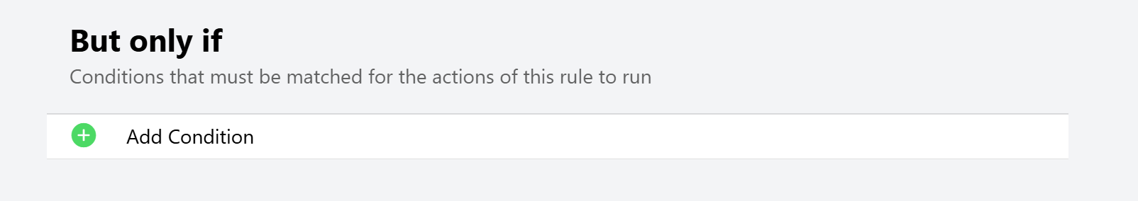

So, it was when I tried to design a new rule following the first case that I discovered the issue with the rule generator. And aswering to your question, these are all the steps:
1) Trigger and Action
configuration: {}
triggers:
  - id: "1"
    configuration:
      itemName: Escena_Dormitorio_1_8_5
    type: core.ItemStateUpdateTrigger
conditions: []
actions:
  - inputs: {}
    configuration:
      command: OFF
      itemName: Casa_Luces
    type: core.ItemCommandAction
2) Conditions

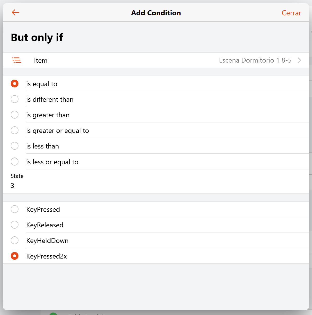

The screen you mention, “ADD CONDITION”, with the four options is shown

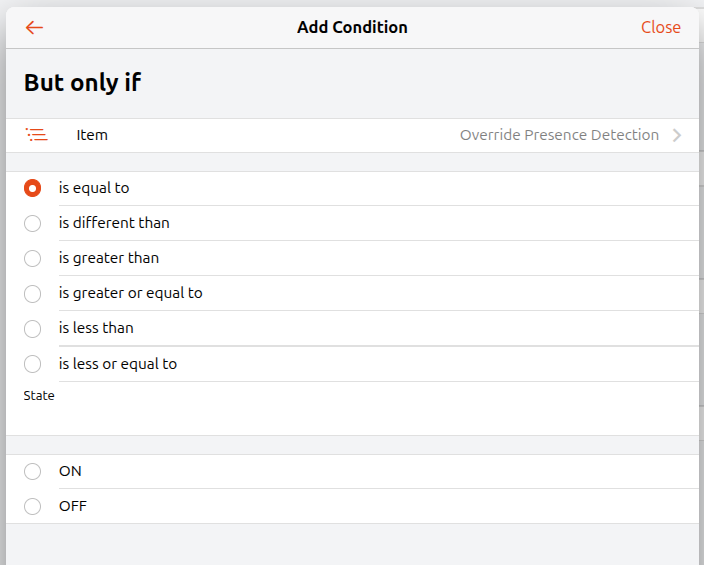

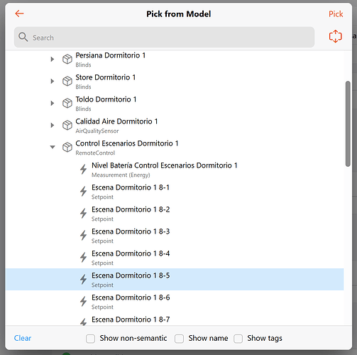

3a) Item condition
I pick the item from the model
3b) Add condition
I select the operator an the state, corresponding to the 5th button of the Remotec ZRC90, and the value 3 for the state “KeyPressed2x”
3c) Closing to go back to rule screen
Nothing happens and there is no condition at all
And there are no conditions in the rule YAML

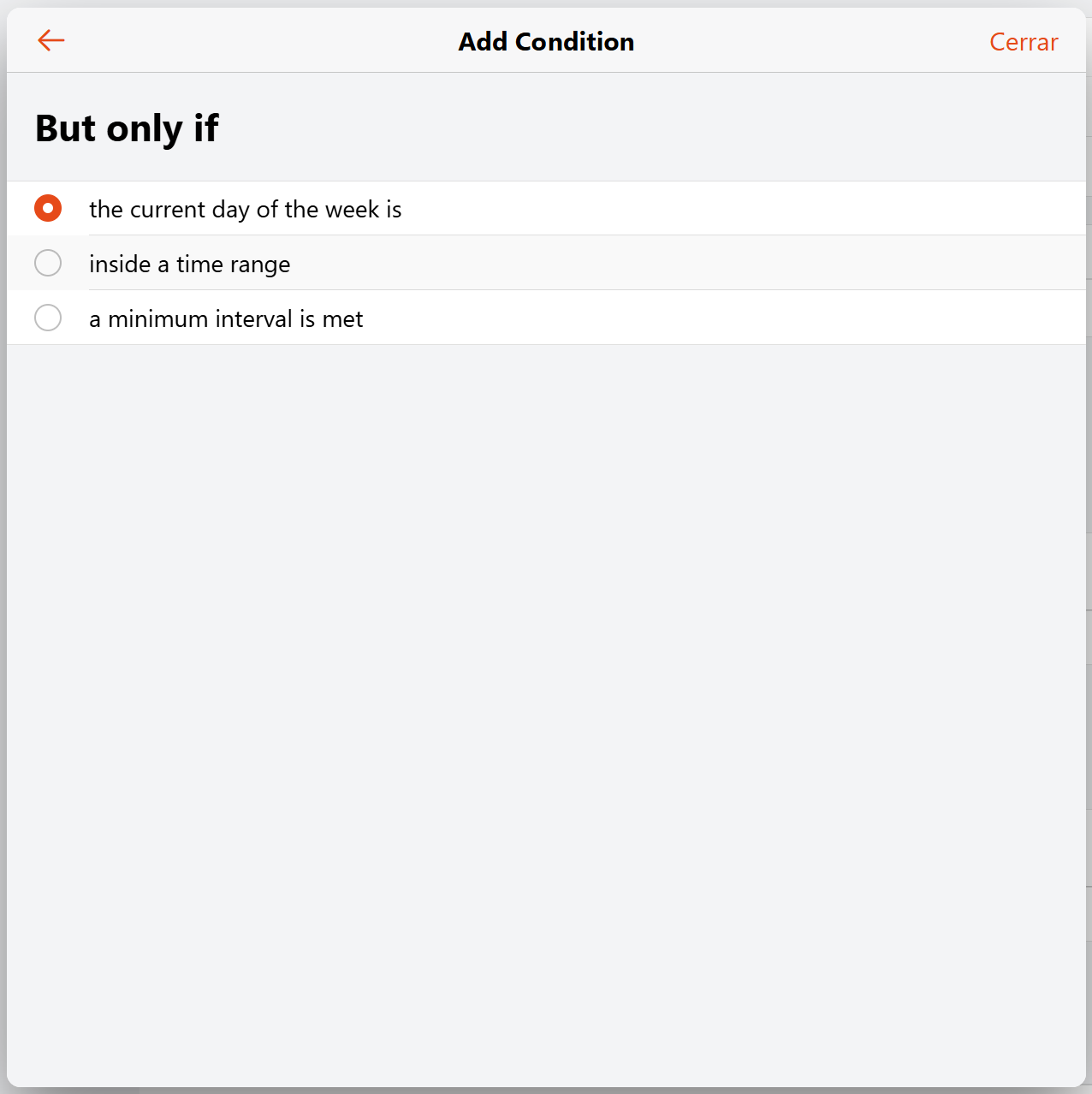

4) Time condition
Impossible to go on with anything

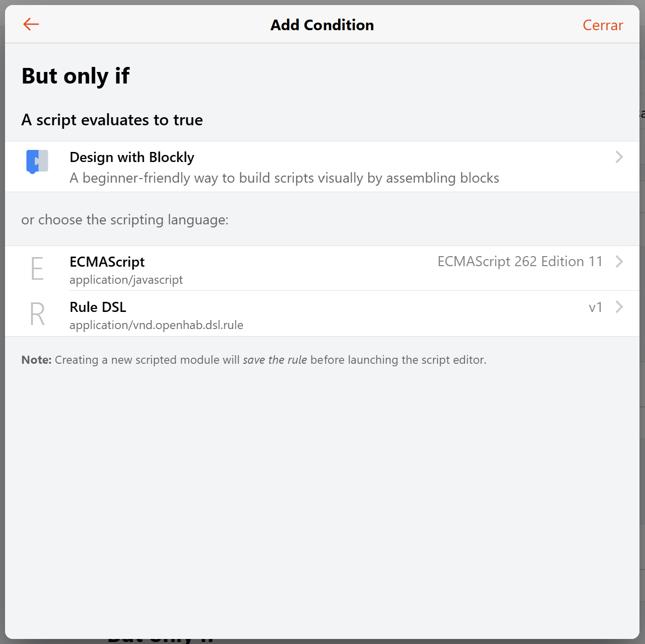

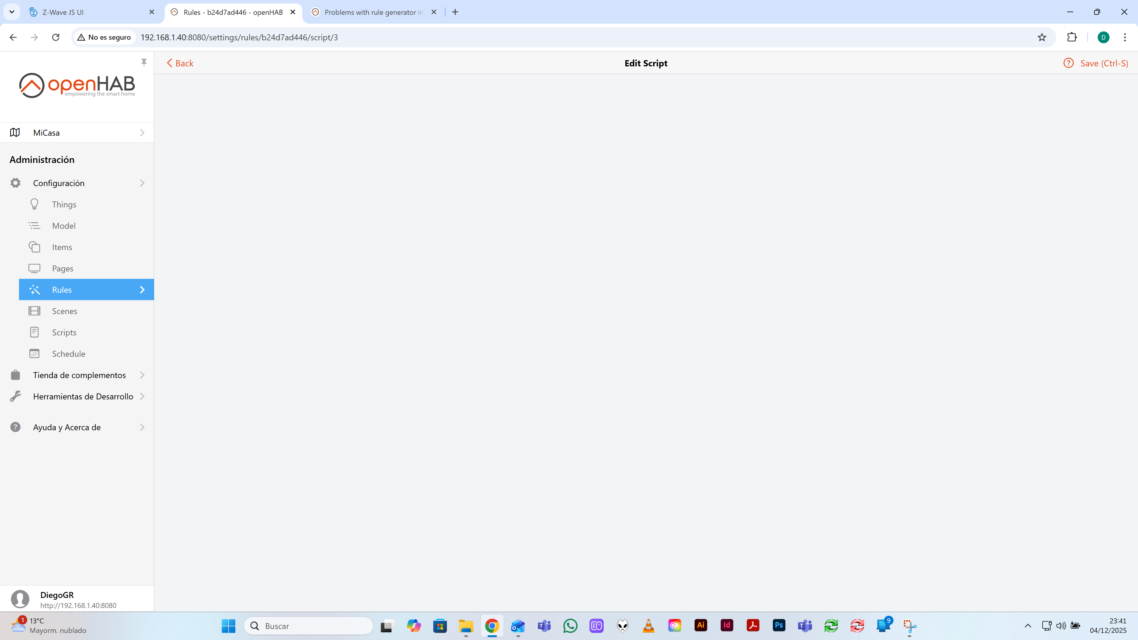

5a) Script condition

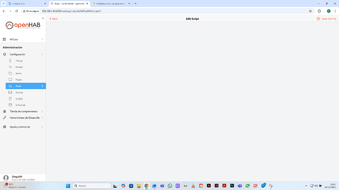

5b) Add condition / Design with Blockly
Nothing to do; all is empty
6a) Ephemeris schedule
I select “It is a weekday”

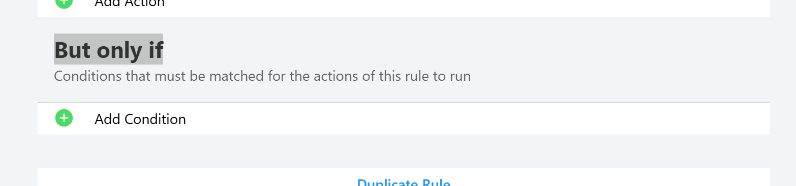

6b) Back to rule
Nothging happens. There is no condition either in the rule screen or in the YAML code

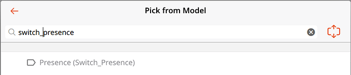

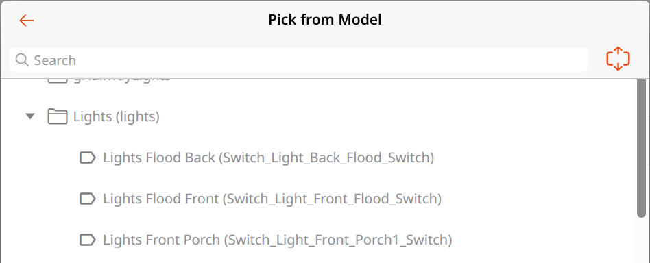

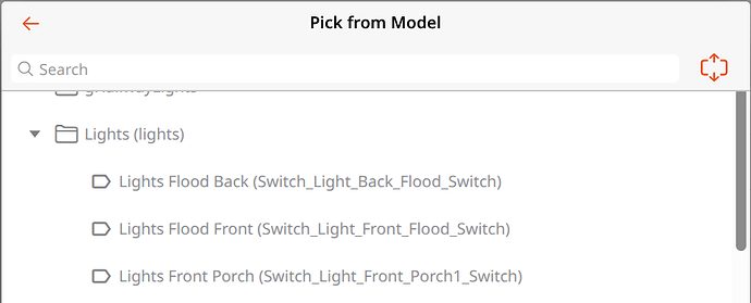

Adding on to this thread since my question is similar:

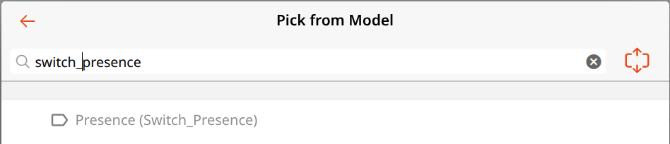

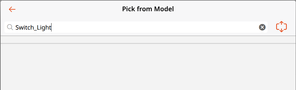

When using the Main UI to write rules, why can’t I find my item name when it’s part of a group? I don’t really use “Models”, so my expectation is that if I enter the item’s unique name in the search field, it should come up as the only match. That, however, works only if the item is not part of a group. And yes, all three checkboxes at the bottom are ticked.
See here:
But there they are:
Item that’s not in a group is found, though:
Do I need to create a “Model” that just includes all of my items unsorted?
Thanks!
I think the model picker search behaviour is a bit „unfortunate“, you need to click the expand icon besides the searchbar.
Or you click on the full entry and not the icon when selecting an item, then a list should open instead of the picker.
Ah, that makes sense, thanks.
I wasn’t aware the search function wouldn’t find an item in a collapsed list.
But I’m only ever getting the picker (using blockly), not the list you mentioned, when clicking on the item name. But I can work with that.
It can indeed be the case that blocks only provides the semantic model picker, I was assuming you were still talking about conditions.
No, pretty much everywhere only the picker pops up. Triggers, Actions, Conditions, etc. Outside Blockly.
