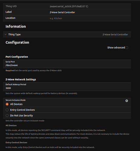

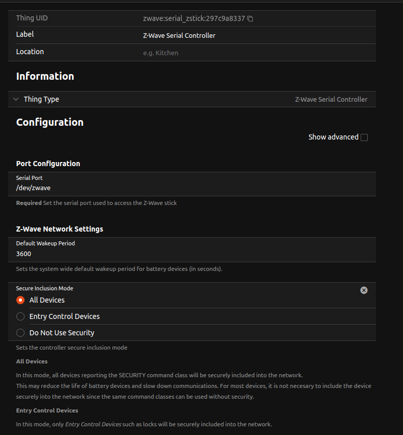

Edit: Also is this node included securely?
I use scan from UI, and add using button on device, as described here, in inclusion section.
IMO, yes. I have all devices.

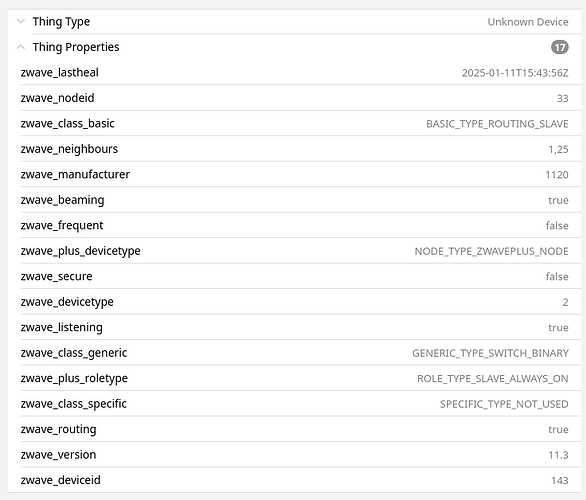

I have a Shelly Wave 1PM Mini here, which gets added as Unknown Device, but Thing Properties show:
  • zwave_devicetype: 2
  • zwave_manufacturer: 1120
  • zwave_deviceid: 143
which seems weird, because Shelly should have a manufacturer ID of 0460 (as my other Shellys have). There is also an corresponding entry in OpenSmartHouse Z-Wave Device Database.
What’s wrong here? Is my device sending a wrong manufacturer ID or is OH doing a wrong mapping? Anything I can do?
I’m running openHAB 4.3.1 Release Build.
This is the same - 1120 is just decimal notation for hexadecimal 460.
It looks like this entry is not yet complete and therefore it’s not available in the binding.

Minor note. Your TYPE is 0x0002 and the device missing the manual is 0x0009. If that device looks good other than the manual missing, your type:ID pair will need to be added.

4a) references to the TYPE:ID, which is not in the XML file - should I post the file content here? Maybe this is, because the device is “partially recognized” somehow?
This is what’s shown in the UI:
From your first post?
143 = 0x008F
