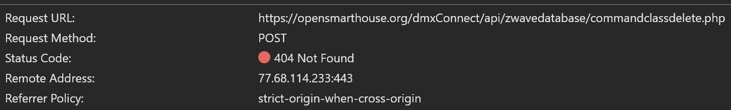

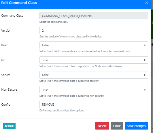

Added the device to the DB and requested a review. I tried deleting the COMMAND_CLASS_MULTI_CHANNEL, but nothing happened. A bug in the web page?
Edit: This seems to be the reason:
I wouldn’t worry about the alarm. I think that is a confusing. Does the device have internal sensors or do you think it refers to if it gets a message from another device? I did not see the parameter section in the attached manual, so really don’t understand.
As to the REMOVE. I did it for you. This will happen when the device is discovered

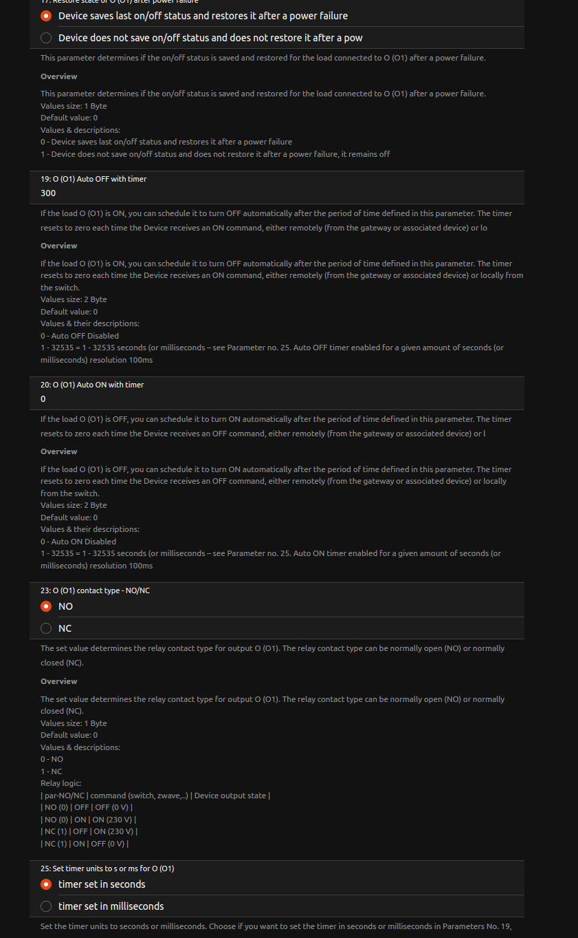

Unfortunately the timers are not working according to me. I set OFF to 300 sec (5 minutes), and the state of the switch does not change.
After 5 minutes nothing change:
openhab> openhab:items list Oswietlenie_na_schodach_Switch
Oswietlenie_na_schodach_Switch (Type=SwitchItem, State=ON, Label=Switch, Category=Switch, Tags=[Switch, Light], Groups=[Oswietlenie_na_schodach])
But I assume it’s not a problem with the bindings themselves, but with the device.
Not unlikely. All we have to go on here is the manufacturer’s documentation :person_shrugging: But if you can get debug logs from when you change the parameter, that might give an indication.
