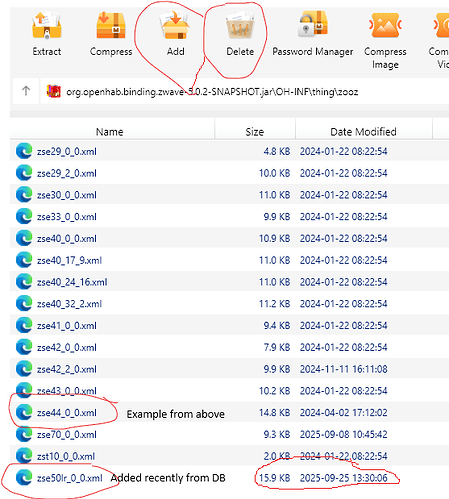

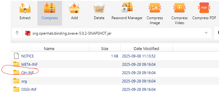

Update: Besides the java modification method, you may be able to edit the XML files in a jar using a compressed file editor. Not a recommendation, but in Windows I have been using BreeZip. Below is an outline of the steps.
After finding your installed jar and moving to a safe location, open with your compression/decompression application. You could see something like this;
The XMLs are in the OH-INF folder. Drill down another level

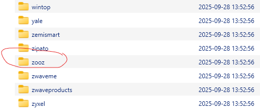

Edit jar22025-09-28 091733

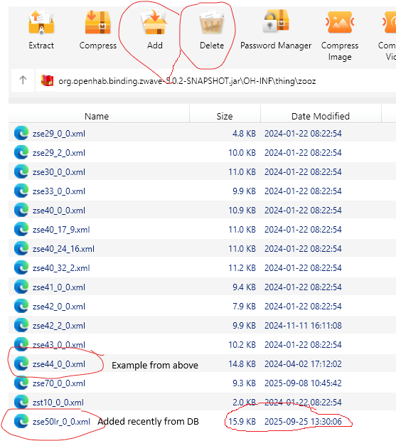

and another to get to the manufacturers. (at least with my app, if your manufacturer is missing, you will need to use the jar modify process to add the folder)
Then add device XML (if new) or delete, then add, if modified (like new channels).
Lastly update bundle as discussed above. To pick up new channels simply delete (do not exclude) the device on the UI and Scan. Your previous configurations and linked items should be persisted.
