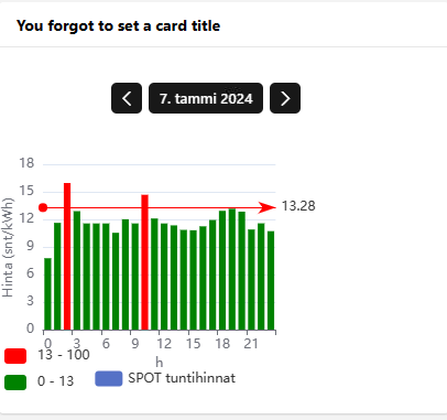

I have a chart widget which plots the hourly Entso spot prices and a markLine for a price limit. The markLine indicates the price limit for switching on our ground source heat pump, i.e. when the electricity price is below this limit the heat pump is on and when the price is higher than the price limit then the pump is off.

So, I have some difficulties with the visualMap part. Item Ouflex_AXL_Reg395 is the price limit.

With this code I get an empty plot but if I use a constant value above for max and min (which are now Number.parseFloat(items.Ouflex_AXL_Reg395.state)), e.g. 15 then I get a plot:
The bars have correct colors as the price limit is 15.12.
I would like to use the numerical value of Item Ouflex_AXL_Reg395 as min and max in the visualMap so I am wondering what is the correct syntax. There was somewhat similar discussion in this thread . This thread was very useful for me because I managed to get the horizontal markLine working.

I have made some progress with my widget but it’s still not working properly. I modified the visualMAP part and the code for it is:

I get a plot:
Note that the price limit is different from the that in the previous plot. The problem now is that if I refresh the page then I get an empty plot. Any ideas what is wrong here?

Yes, I see some errors but I don’t understand what they mean. I have made some more tests with my widget. I added line “show: false” so the visualMap code is:

I made a test page with widgets with and without the “show: false” line. At first both plots are shown (see below):
When I refresh the page then the plot on the right hand side is empty. This widget is without the “show: false” line. The problem appears with all browsers (Firefox, Edge, Chrome).
I have no ideas why this happens.

When I open up my test page the console has no errors. When I refresh the page then the Chrome console shows following errors:
app.e6719a8d0e1675221dee.js:7 TypeError: t.indexOf is not a function

I have no ideas what they mean. The errors are related to the widget on the right hand side above and the widget doesn’t have the line “show: false”.

I’d say this is definitely worth a bug report. The trouble is it’s still not 100% clear whether that should be in OH or eCharts.
What version of OH are you using?

@JustinG , many thanks for your help. Sorry that I didn’t mention in my first post that I’m running OH4.1.0. I don’t know whether this bug was already in previous OH versions or not because I have been using my widget with visualMap only under OH4.1.0. I’ll submit a bug report tomorrow. Should I include my widget in the bug report?

Best rule of thumb is always to include as much as you can. It is always easier for someone reviewing an issue to skip over information they don’t need than to have to continually ask for further clarification.
Include the widget, include the error code, include a link to this discussion, include all the information that the issue template asks for even if you don’t think it’s likely to be relevant (you never know).

@JustinG , bug report now submitted (# 2262). Many thanks for your help.
