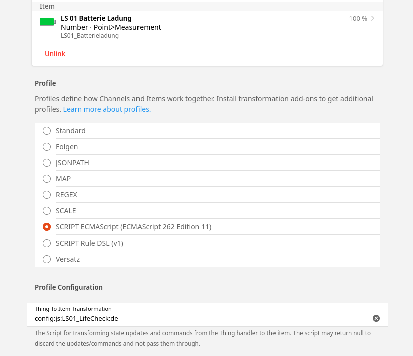

I check the presence of z-wave devices (battery flat even status is 100%) by setting a “life” switch item when data are send. Switch goes off after 25h, if it is not updated within time, showing device is dead.
For setting the “life” switch item I use profil js SCRIPT in the channel config.
(function(data) {
  items.LS01_LifeCheck.postUpdate('ON')
  items.LS01_LifeCheckTimestamp.postUpdate(Date.now())
  return data
})(input)

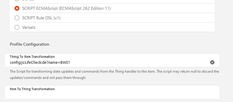

Is there any way to get more parameters into the function, like channel name etc. So I can have a universal code by assembling the item name as it is always LS01-LS05_LifeCheck or BW01-BW05_LifeCheck.

The value of blindAddress is set in the call to the transformation line like this.
JS:config:js:Trans_BlindCmd?blindAddress=SX6
So in your profile transformations, add a ?variablename=value to the end of the call to the transformation and then you can use variablename in your JS script.
I haven’t tried to use multiple variables but you can try seperating them with a ;
Separate multiple parameters with a & just like in a URL
transformation?arg1=val1&arg2=val2
Just as an example, if someone needs it.
(function(data) {
  itemname = name+'_LifeCheck';
  itemname_time = name+ '_LifeCheckTimestamp';
  items.getItem(itemname).postUpdate('ON');
  items.getItem(itemname_time).postUpdate(Date.now());
  return data;
})(input)
