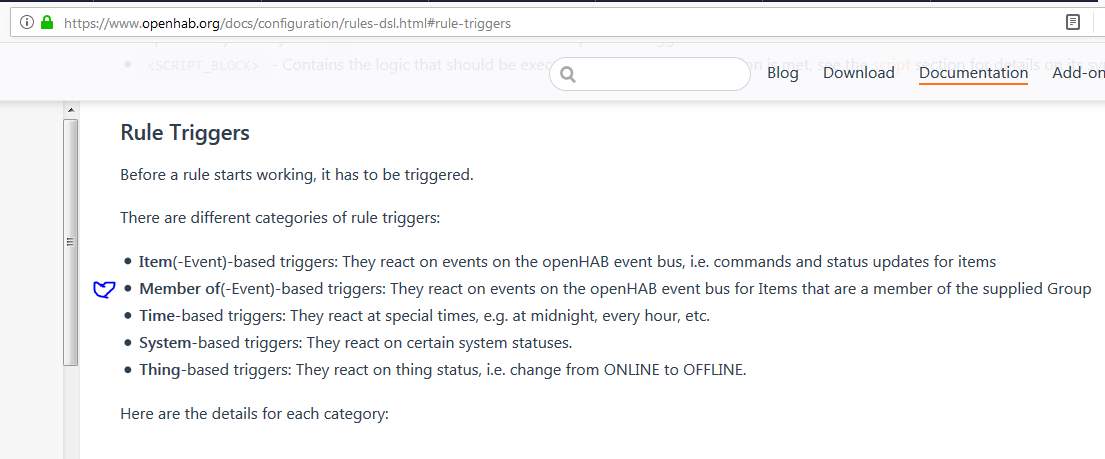

hm, “Member of…” triggers do not seem to be in 2.3 … at least I haven’t found it in the docs -. and repectively it does not work (trigger rule to fire) … considering an update.
edit (again) they should be on 2.3.0 Stable
see: Design Pattern: Working with Groups in Rules - #70 by Nicholas_Waterton
and: Textual Rules | openHAB
This: Allow binding DSL Rules to all items contained in a group by jmsjones · Pull Request #4800 · eclipse-archived/smarthome · GitHub was merged on Jan/18 and OH2.3 stable was released on May/18, so it should be there
Well, you are right - it seems they are triggered - but items change rarel< - why i did not see any effect. Interstingly the 2.3. documentation does not list the triggers (same spot wheer 2.4 docu lissts them)

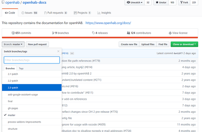

latest
long, painful story :slight_smile:
most of us (including me) update only the latest version (2.4) of the docs on the master branch (even when the updates apply to both 2.3 and 2.4).
Ps: don’t let @Confectrician see this :slight_smile:
no offense :slight_smile: - THX for helping and the great work!
Theoretically we would have to cherry pick those pull requests to the stable docs and then re tag so the build recognizes them.
That’s really much effort, to be honest.
So I am blaming no one for not adding stuff to the stable docs. :smile:

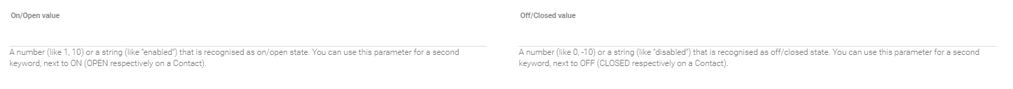

First of all, this can be done in the Channel config for the MQTT 2 binding.
Just put “on” in the “On/Open Value” section and “off” in the Off/Closed Value section.
A Profile is overkill for this.

I see the channel configuration now. I was looking for a binding config. Can I edit the paper ui config if thing is defined in .things file?
Any documentation on how to define these parameters in the .things file?
Edit: updated image. I’m not sure how the “1”/“0” got here, but that answers that question.

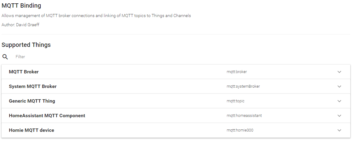

There is no separate configuration. Create Things as documented at:
https://www.openhab.org/addons/bindings/mqtt.generic/
