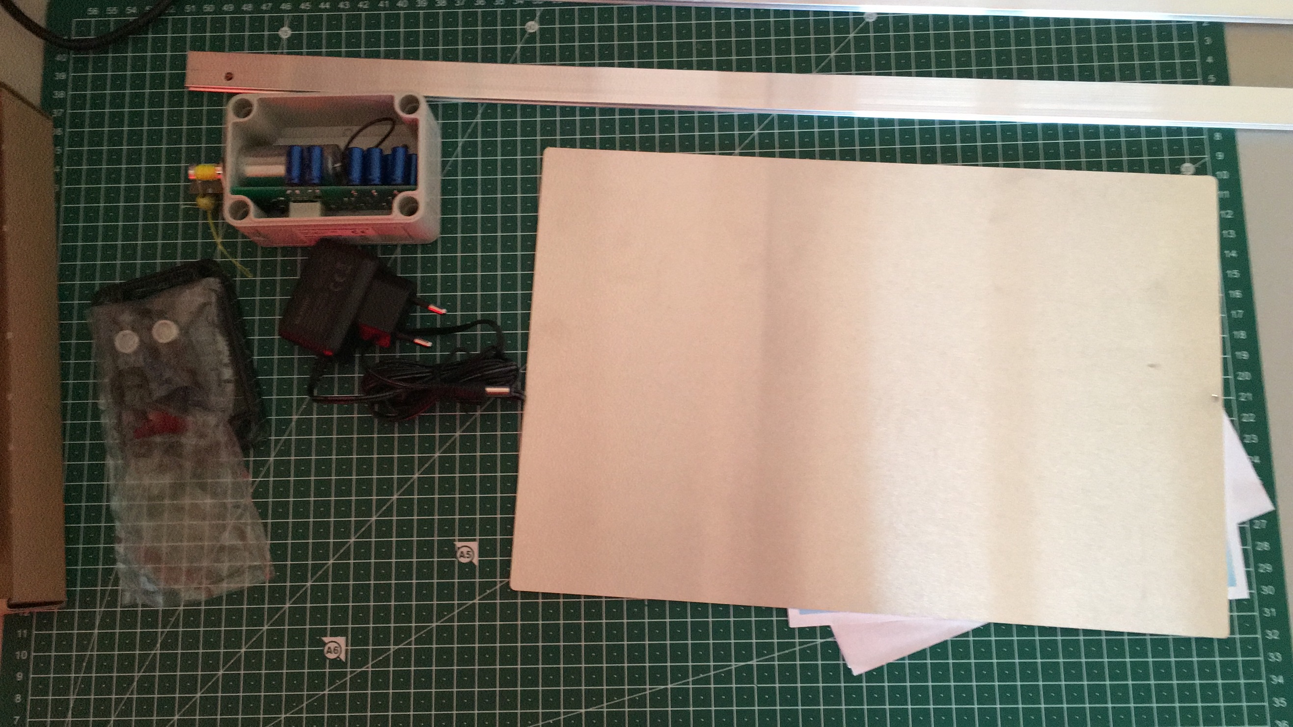

What i want to document here (if anyone maybe needs it):
Im bored of closing the door of our chickenhouse every day after sunset, so i thought about a way to close it automatic. first i wanted to have an out of the box solution - but after a few research and after i started using OH i decided to build an automated lid.
the trigger will be a light sensor which i will check with an OH-rule, this rule will then control a wemo plug or something (tips welcome)
