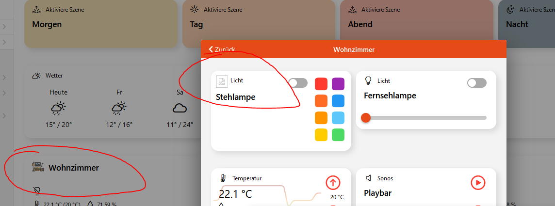

Hello there,
openhabian 5.10.17-v7+ #1421
Release = Raspbian GNU/Linux 10 (buster)
Kernel = Linux 5.10.17-v7+
Platform = Raspberry Pi 3 Model B Rev 1.2
Openhab 3.1.0
I’ve switched to OH3 a few days ago, I found a lot of tutorials and Widgets from other persons.
So I decided to try and error with some.
anyways, I can’t figure out why I can’t change the icon’s
the path telling me its located under /static
So in HTML, there is a Readme.txt which explains, if I can enter my IP/static/picture.png it should be displayed in the browser → that works for me.
So why the icon is not shown up ? it’s a normal .png icon.
Widget:

Config Widget
component: widget:Cell_Light_Color_Card_2
  title: Licht
  header: Stehlampe
  iconimage: idea
  item_schalter: TRADFRIGluehlampeWhz_Farbe
  item_color: TRADFRIGluehlampeWhz_Farbe

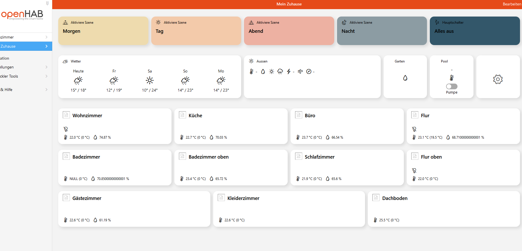

I can’t figure out how the Properties inside a widget is created ?
My Concept of the Model is:
→ Floor → room → Sensor → Values is that correct ?
I displayed it here:
summarized:
I can’t figure out, how to get Icons into place
And I can’t figure out, why the properties are not created for the rooms.
If someone can help me with this, I would be thankful

It’s hard to say what you are doing though as none of your images are showing up.

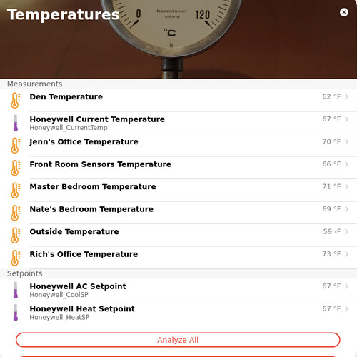

Point Items also support an optional Properties tag. The Point tag says what the Item does and the Property says what it does it to. For example, a thermometer reading Item would have a Measurement Point tag and Temperature Properties tag. The setpoint for a thermostat would have a Setpoint Point tag and a Temperature Properties tag.
The Locations tab of the overview page will show one card for each location. In that card there will be potentially two tabs. One showing the equipment that is in that location and another showing the Items that have both a Point and Properties tag that are direct members of that location and not a member of an equipment.
The Equipment tab of the overview page will show one card for each type of Equipment (based on the Equipment tag) and show each of the Point Items that are members of that type of Equipment inside the card.
The Properties tab will show one card for each type of Property used (e.g. Temperature) listing all the point Items that have that property type inside the card grouped by their Point tag.

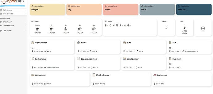

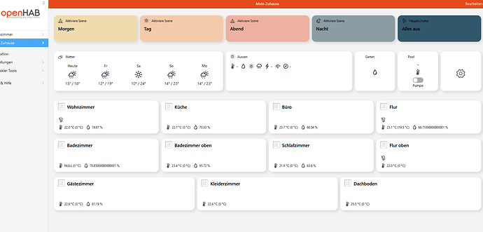

I try it again:
So my location “Erdgeschoss” is a Group → correct
My Location inside “Erdgeschoss” is a Group called “Wohzimmer” and got the semantic class “living room” ← for what I define this ?
Inside my Group “Wohnzimmer” I have the type of Equipment that sorts my devices.
Lets go ahead with “Sensoren Wohnzimmer”.
“Sensoren Wohnzimmer” has 2 points
→ 1. “Luftfeuchtigkeit” semantic class: Point_Measurement and is a direct parent group to “Sensoren Wohnzimmer”
→ 2. “Temperatur” semantic class: Point and is also direct grouped with “Sensoren Wohnzimmer”
I guess my whole construction is wrong correct?
I think the group “Sensoren Wohnzimmer” should also display the points ?
For me I only get NULL so there’s something wrong I think.
I could change that by changing the members base type → but there I got 2 different measurements that can’t be displayed as one.
I am sorry, but my mind is a blockade… maybe I should have used the model construction in OH2 as well… I’ve never gave that attention.
I would be glad, if u can help me a second time in this case

Again, none of your screen shots are showing up for me so I can’t see anything in the posted screenshots that might help.
If all you care about is the Overview Page that tag isn’t used for much beyond helping you add more context and meaning to the model for your own sanity or for use in Rules (you can get the parent Location and Equipment a given Item belongs to in a rule). But in the future and today using HABot that is how you distinguish between location types. That’s what lets you issue commands to HABot like “turn off all the lights in all the bedrooms”.
And the Property tag? As I said above, an Item with a Point Tag can have an optional Properties tag. So what is the Luftfeuchtigkeit Item measuring? That is the Properties tag. So if it’s measuring light levels, for example you’d use a Point tag of “Measurement” and an additional Properties tag of “Light”.
For the Temperatur Item you haven’t applied a Point tag at all. Temperature is a Properties tag and a Properties tag is meaningless without a Point tag.
On the Locations tab you should have a gray line with “Sensoren Wohnzimmer” in the “Wohzimmer” card. Under that gray line will be the two sensor Items listed, one per line. However because Temperatur doesn’t have a Point tag it won’t be shown because it’s not a Point.
On the Equipment Tab you should see a card for each of your Equipment Tags. Inside that card you will see a gray line for each Group Item tagged with that Equipment tag. Under that gray line you will see the points that are a part of that specific instance of the Equipment.
On the Properties tab you will see a card for each Properties tag in use. Remember, a Properties tag cannot exist on its own, it must be paired with a Point tag. The way it looks was posted and described above.
Notice in the above description the neither the state of the Location or Equipment Item is never mentioned. That’s because it’s never used anywhere on the Overview Pages. The states of these Group Items do not matter and are not used anywhere.

I’ve only got the Icon problem left.
It’s not a dynamic icon. → it’s a normal icon as usual in OH2.
It works sporadically… its a bit confusing…
So my problem was, I didn’t create the ICONS folder inside HTML → I created at first a static folder ← that was wrong…
After creating the Icons folder inside
\\192.168.178.50\openHAB-conf\html
I can see “sometimes” the icons…
Hopefully, u can see my screenshots now.
As I said, I’ve created the Icons folder inside HTML now my icons work for the overview page if I tab on the “Openhab logo” in the uppfer left → starscreen
You can see, that my icons pop up correctly.
BUT If I click on the “Tab” of the SAME page which is named “Mein Zuhause” on the left → the Icons won’t show up…
How is that possible ? cause it is on the same page. I only got one overview page.
Same for the PopUp widgets → I configured the same icons → which works fine on the overview page.
I think I am running in a circle… cause I can’t find the error for this
