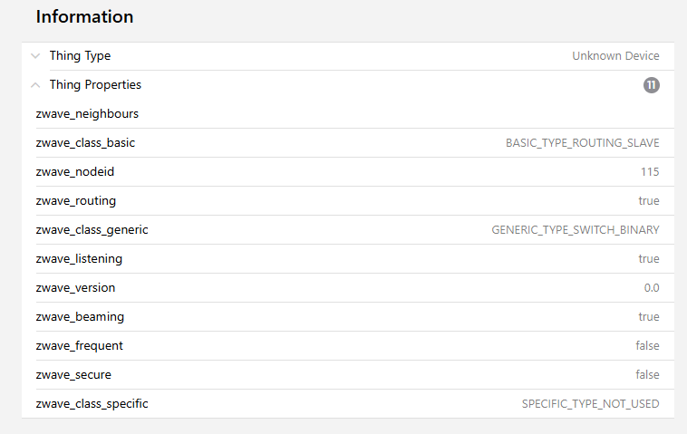

Not sure if we’re using the same terminology:
  • Scan finds node without device specific info
  • Add device shows up in things, no channels “This thing has no channels. Either the thing type doesn’t define channels, or they may be detected and appear later.”
Thing properties:
Yes, that’s how it looks when the thing-type is missing. But, the binding must know the thing-type before the scan. I usually don’t create the Thing until it has been “recognized” while in the inbox. I don’t know if that actually matters, but it can take some time before it changes from “unknown device” to the actual device.

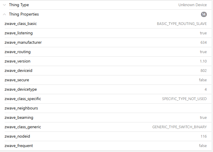

Thing Node116 properties now shows 14 (was previously 11). Progress?

It seems like the new node id is 116 - so is there no file there for node 116?
That said, it looks to me like the device has been “discovered” as far as you can expect without the thing-type. I don’t know if it helps to add the thing-type now (if the “resolving” will continue) or if it’s now “too late” and it has given up identifying the device.
I would think that just deleting the Thing and scanning again would restart that process though, which could be done once the thing-type is in (add-on reinstalled and OH restarted).
It says manufacturer ID 634 - which seems to match what is in the thing-type configuration (0x27a is hex for 634 decimal).
    <properties>
      <property name="vendor">Zooz</property>
      <property name="modelId">ZEN58</property>
      <property name="manufacturerId">027A</property>
      <property name="manufacturerRef">0004:0322</property>
      <property name="dbReference">1687</property>
    </properties>
Device ID 802 decimal = 0x322 hex so that also seems to match, however I’m not sure what 0x0004 refers to. This is where I thought @apella12 what know.
What I do know is that these values must “match” for the thing-type definition provided to be applied to the device/Thing.

It shows in OH with
  • zwave_manufacturer 271 (0x10f hex)
  • zwave_deviceid 4096 (0x1000 hex)
So, it seems like it “should” match, except that I’m not sure what the first part of the manufacturerRef is - in my case they are all 0102 - in your case it’s 0004. Converting 0x0102 hex to decimal gives 258, which happens to match what zwave_devicetype is in my device. The same is true in your instance, zwave_devicetype is 4, so as far as I can tell, it should have “matched” with the thing-type, if the definition had been known during discovery.
The log snippet is a little short, but it seems to be discovered (at least the type:id are verified). As noted by @Nadahar is there an XML with node116? It should look like this;
network_xxxxxxx__node_116? If yes step one is complete. If not you didn’t capture the full inclusion log, so can’t tell what happened. What might help is to use the zwave log viewer on your file. I’m looking for the DONE. That is when the record XML is written
Edit: Example from the archives;
