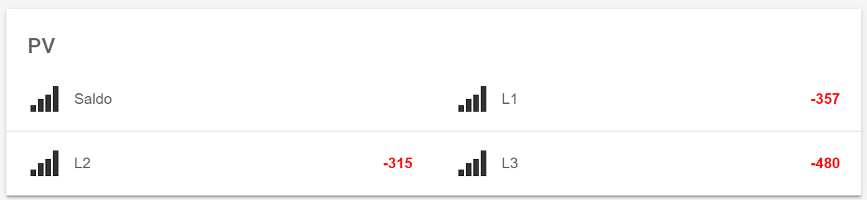

I tried to create an proxy item. But it will not update.
The rule is fired and i can see the output in the logs.
But the update of the proxy item will not be shown.
I want to add the the power values L1, L2 L3 to calculate the balance.
Then i want to store the values to create an chart.
But i can not update the item with the display name “Saldo”. Where is my mistake?
My item is shown in the sitemap but without any display:

@jimtng has the solution to your specific problem.
