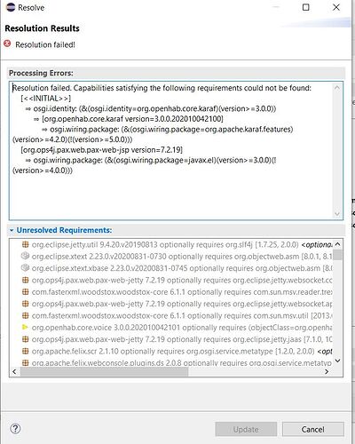

One error remains when i click on resolve though:
Resolution failed. Capabilities satisfying the following requirements could not be found: [<>]
⇒ osgi.identity: (&(osgi.identity=org.openhab.core.karaf)(version>=3.0.0))
⇒ [org.openhab.core.karaf version=3.0.0.202010020627] ⇒ osgi.wiring.package: (&(osgi.wiring.package=org.apache.karaf.features)(version>=4.2.0)(!(version>=5.0.0))) [org.ops4j.pax.web.pax-web-jsp version=7.2.11] ⇒ osgi.wiring.package: (&(osgi.wiring.package=javax.el)(version>=3.0.0)(!(version>=4.0.0)))
[jakarta.activation-api version=1.2.1] ⇒ osgi.wiring.package: (osgi.wiring.package=com.sun.activation.registries)

If you have a resolution error the demo app won’t work. So this needs to be fixed. Did you also installed openhab-core with the eclipse installer?
I did not, is this required?
No its not required. Its actually not recommended and not needed if you develop a binding. I asked to check if that might be a possible addition additional source of the problem (not that it actually might be a problem)
The package it fails on doesn’t ring any bells. There where some changes the last days that caused errors, but afaik these where different problems. Can you rebase your branch to the latest main code both in openhab-addons as well as openhab-distro to just see if this makes a difference.
