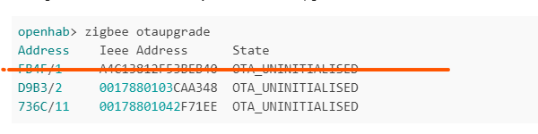

Hi @chris ,
i thought that this commands says that the OTAUpgrade was initalized.
openhab> zigbee otaupgrade
Address    Ieee Address      State
FB4F/1     A4C13812F53BEB40  OTA_UNINITIALISED
D9B3/2     0017880103CAA348  OTA_UNINITIALISED
736C/11    00178801042F71EE  OTA_UNINITIALISED
This also remains when i reboot openhab or disconnect the stick.
Then i run
openhab> zigbee otaupgrade cancel 64335/1
OTA Upgrade cancelled on endpoint FB4F/1
And then i would expect the first one to disappear, or did i got it wrong?
Nothing will disappear. The otaupgrade command will simply list all the known servers and the transaction state. Using the cancel sub command won’t do anything if the transaction is not initialised (as is the case).
The “first one” will therefore not disappear - the server is still there and the transfer state is still uninitialised.
Chris
