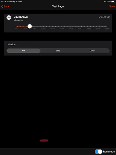

Or you use a widget with positions ( lower example), setting the item to 1 if moving left, 2 if moving right. A rule (or exp. Timer) centers the push button after 1 second by setting the item to 0

you may try the widget code
uid: Karte - Schieber 3x
tags: []
props:
  parameters:
    - label: Headline
      required: false
      type: TEXT
    - label: Headline Color
      required: false
      type: TEXT
    - label: Headline Weight
      required: false
      type: TEXT
    - label: Left Button
      required: false
      type: TEXT
    - label: Mid Button
      required: false
      type: TEXT
    - label: Right Button
      required: false
      type: TEXT
    - context: item
      label: Item
      required: false
      type: TEXT
    - label: Background
      required: false
      type: TEXT
timestamp: Dec 10, 2022, 6:01:58 PM
component: f7-card
  style:
    background: '=(props.background) ? props.background : ""'
  default:
    - component: Label
        style:
          color: '=(props.headlinecolor) ? props.headlinecolor : "white"'
          font-weight: '=(props.headlineweight) ? props.headlineweight : "normal"'
          margin-left: 25px
          margin-top: 0px
          padding-bottom: 0px
          padding-top: 15px
        text: '=(props.headline) ? props.headline : "Headline"'
    - component: f7-card-content
        default:
          - component: f7-segmented
              raised: true
              round: true
              strong: true
              default:
                - component: oh-button
                    action: command
                    actionCommand: 1
                    actionItem: =(props.item)
                    active: =(items[props.item].state === "1")
                    text: '=(props.leftButton) ? props.leftButton : "1"'
                    action: command
                    actionCommand: 0
                    active: =(items[props.item].state === '0')
                    text: '=(props.midButton) ? props.midButton : "2"'
                    action: command
                    actionCommand: 2
                    active: =(items[props.item].state === '2')
                    text: '=(props.rightButton) ? props.rightButton : "3"'

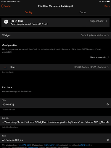

What part of this display a custom widget will replace? The complete line, from the label to the switch, or only the switch?
widget
I mean, when using the Metadata ‘Default List Item Widget’…
You can modify every thing. No matter whether it‘s been a normal item or a group item.

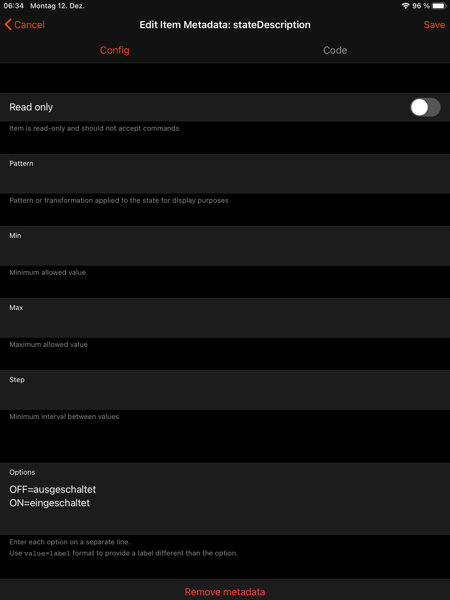

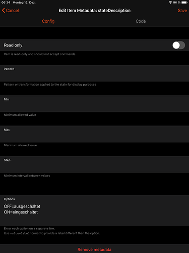

  1. Options in stateDescription changes the expression of the state
  2. selection of widget change the whole design ( here Default(oh-label-item). You can choose what ever widget is available, see also widget market.
  3. for title etc just put in a word like „powerplug“ or an expression starting with „=„ like I did in the subtitle.
  4. when highlighting „show advanced“ another input field becomes available „after“. This can be used to show anything else then the item value
So the whole system became so complex, that you will discover new stuff every time you modify any input field
and that‘s how it looks like in the „equipment“ view , segment poweroutlet. Every group has a different layout.
