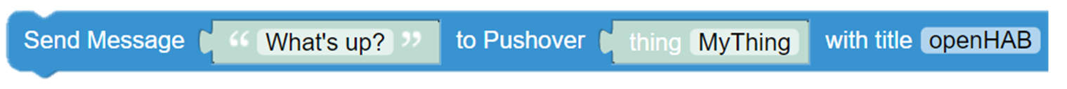

Send Message
Will send a basic message to the configured account with a default title openHAB, which can be overwritten

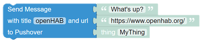

Send URL Message
Will send a message with a configurable title to the configured account.
The message will have a url at the bottom, which can be opened from pushover directly.

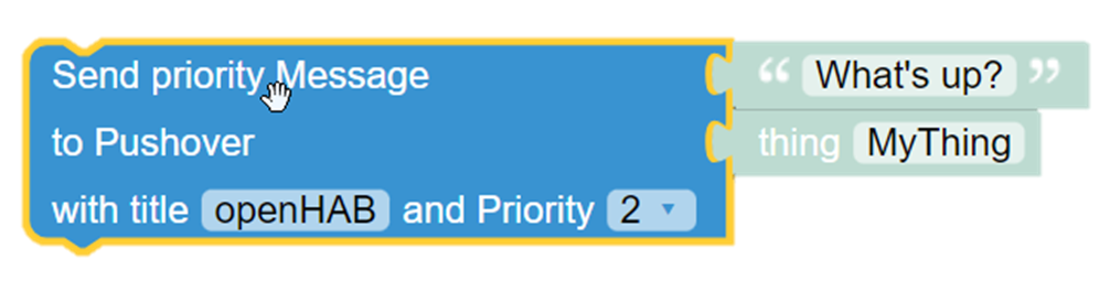

Send Priority Message
Will send a priority message which has to be accknowledged.
Priority can be configured in 5 available levels. (Defaults to 2)
Note: Cancelling and handling action return values is not supported currently.
