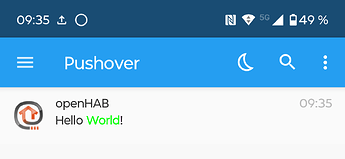

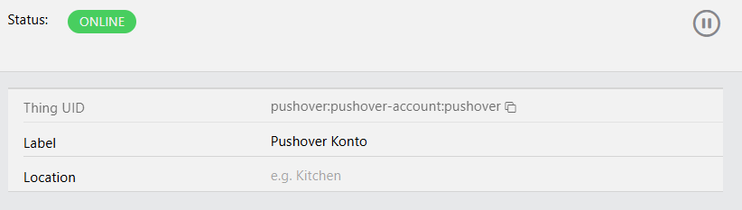

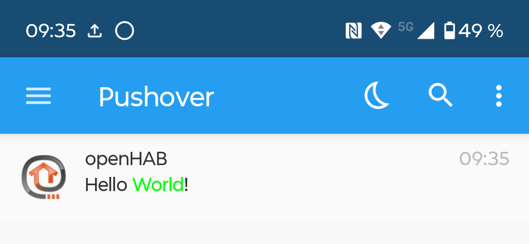

rule "test pushover"
Item Test1_Switch changed to ON
val actions = getActions("pushover", "pushover:pushover-account:pushover")
// send HTML message
actions.sendHtmlMessage("Hello <font color='green'>World</font>!", "openHAB")
Make sure you have the correct syntax in your action:
