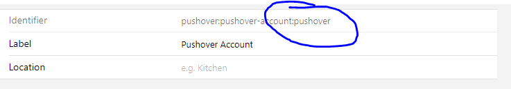

What exact part are you circling in your pic?
Sorry to be a nuisance. Thanks

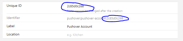

When I added a pushover thing(the main binding), it’ll look like this at the top :
Where I circled in blue is the ID. So if yours had that 2c8…number in there, it would look like this for the rule :
val actions = getActions(“pushover”, “pushover:pushover-account:2c85d0c268”)
