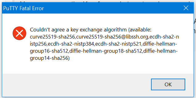

I’ve been running 2.5 for some time with no issue. I’ve started a new install on a PI4. Everything went well. The next step is to recreate my 2.5 install, however, I cannot login with Putty. I’ve tried the default password and port 8101 to no avail. Any tip would be most welcome.

Update 2: All good now. I’ve updated to v0.76 of Putty and now it’s working as advertised.
Thank you.
Update: I’m able to connect with my MAC in the terminal window, using: ssh openhabian@192.168.86.46 Still no love with Putty on my PC… Investigating.
