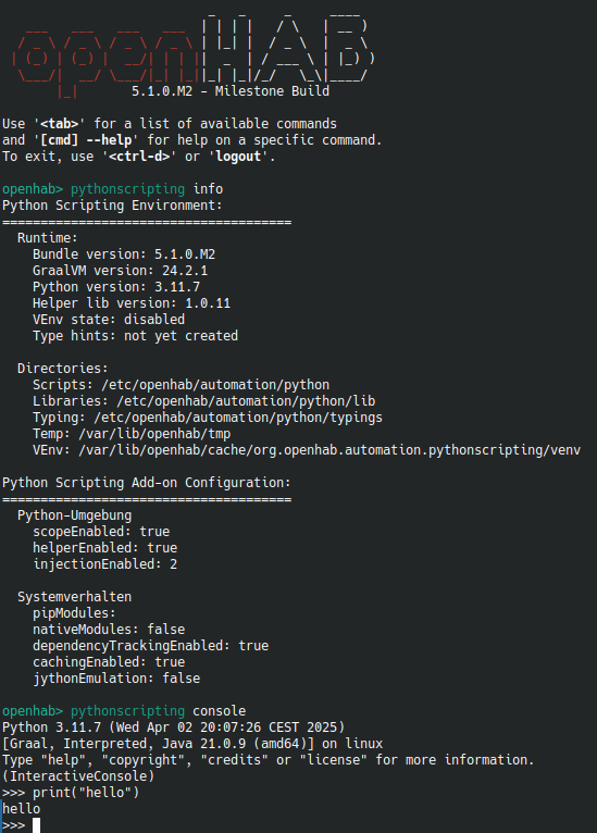

@michalsrb I can’t reproduce. I was trying the following steps.
  1. I installed a clean opensuse leap 15.6 in a VirtualBox VM
  2. I installed java 21
  3. I added the jfrog testing repository
  4. I installed openhab and openhab addons
  5. I started openhab with systemctl start openhab
  6. I opened the webui and activated pythonscripting by clicking on “Install”
  7. I opened the openhab cli with openhab-cli console
  8. And below you see the result
Thank you for going such lengths to try to reproduce it. I also tried to install it in fresh VM and it works. I’ll try to get the configuration in the VM to match my system’s configuration and see if it breaks at some point or if I can spot a difference…
