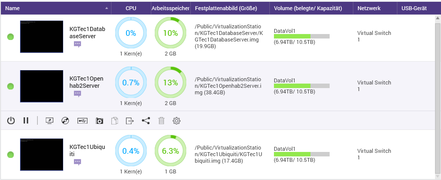

Yes - I’m using a TVS-671 with the following VM, all running standard Ubuntu:
  • Openhab - Current live system, stable 2.2
  • Openhab Test enviroment, was mainly used for migrating from OH 1 to OH2
  • InfluxDB and Grafana
  • Ubiquity Controller
I’ve also had another VM with Zoneminder, however I deleted that as I never got it to work - I’m using a bunch of Raspberries now with local motion dection, uploading the recorded videos to the QNAP and from there to the cloud - works better than zoneminder for me. From time to time I also add other VM for testing purposes, never had any performance issues. Openhab installation is as easy as apt-get openhab once you have the repository configured, somewhere is a guide on how to do that - no issues at all with this. You can even switch between stable/testing/nightly build with this, however don’t try this on your live system as I did - You might encounter some bugs :slight_smile:
Issues I had were mainly my own stupidity - I’ve lost a bunch of Unix scripts to interface to my Zipato controller as I deleted my OH 1 VM without moving these to the new system. Furthermore I was too lazy to move all my old persistence data from rrdj4 to InfluxDB when I did that migration, unfortunately someone published a migration tutorial somewhere here almost exactly after I deleted my old OH 1 VM with the rrd4j data again…

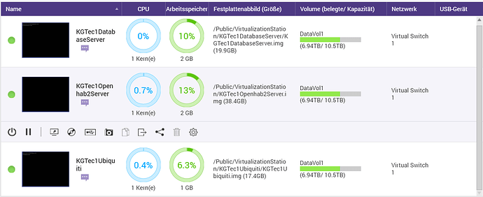

It is possible to connect physical USB ports to VM during startup of the VM, with this I’m using a zwave stick and a plugwise stick without issues. Sometimes in the past the sticks were not automatically connected during boot but this got either fixed or it was my own stupidity as I was switching between two VM for openhab. CORRECTION: As you can see in the screenshot below the USB ports were not corrected - It seems after rebooting the QNAP you have to manually map them again, rebooting the VM itself will keep the mapping - I did a upgrade of the QNAP earlier today and rebooted it.
Mine has an Intel Core i5 with 16GB of RAM, utilization of the VM is really good - I had all VM configured with 2 kernels and 4GB of RAM before but reduced them recently. I also think of moving my Plex server from the QNAP itself to another VM on the same system due to maintainability.
