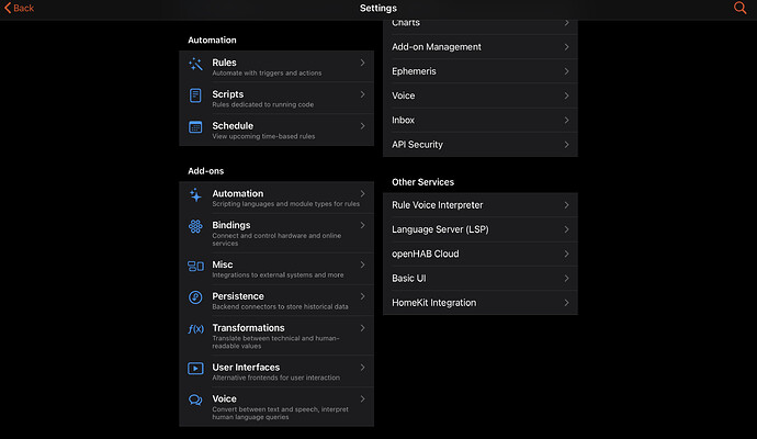

The settings for HomeKit binding with the qr code is listet at „other services“..at least for me.
It used to show there for me too, but not with the snapshot installed
Mhh… this is strange.Shows it to me with the snapshot version.

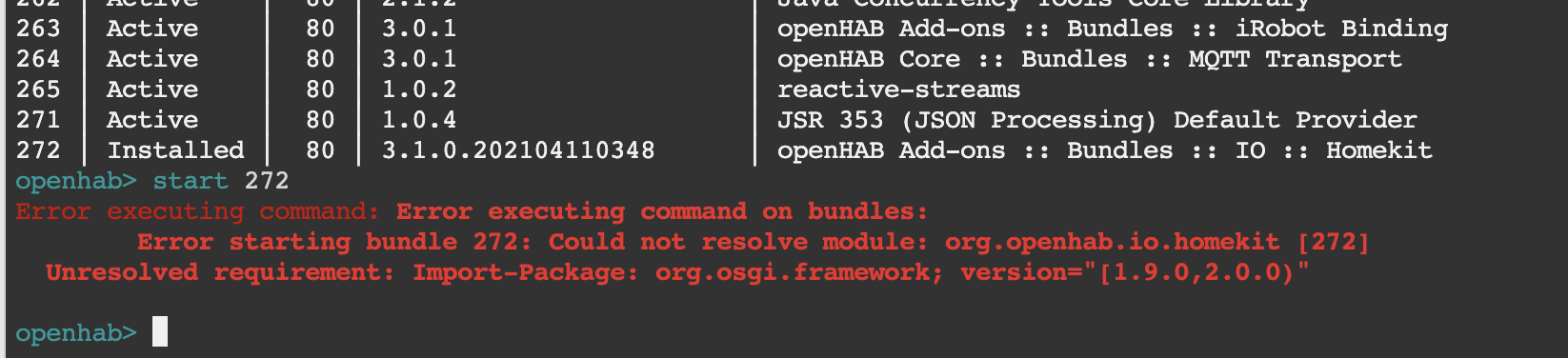

When I do this, I get this:
Error executing command: Error executing command on bundles:
Error starting bundle 284: Could not resolve module: org.openhab.io.homekit [284]
Unresolved requirement: Import-Package: io.netty.bootstrap; version=“[4.1.0,5.0.0)”

Except now the error when I try to start is:
Error starting bundle 305: Could not resolve module: org.openhab.io.homekit [305]
Unresolved requirement: Import-Package: org.osgi.framework; version=“[1.9.0,2.0.0)”
which is slightly different than when I used the previous snapshot (26) yesterday, which read:

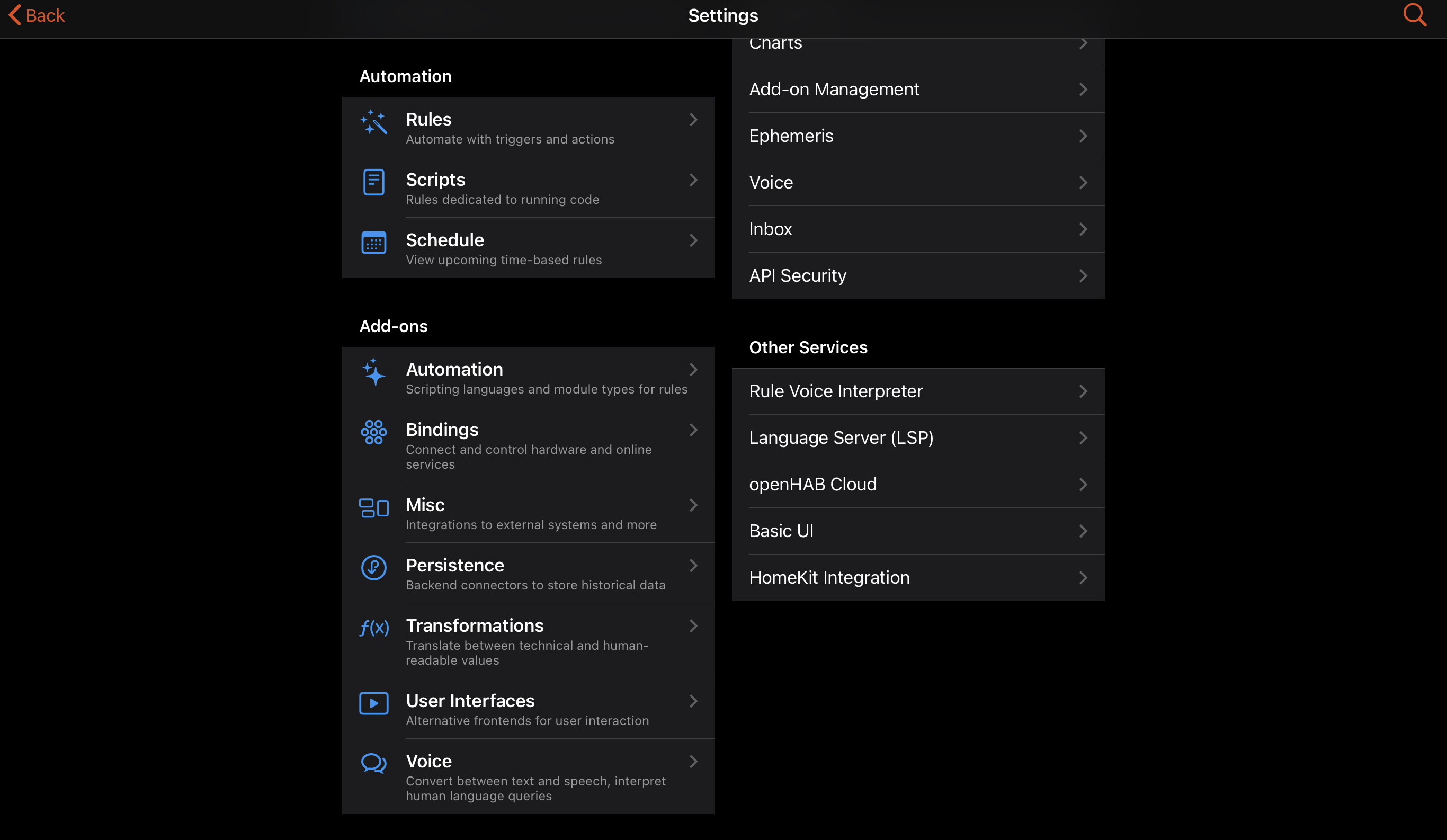

I got a bit of a scare when all Things were UNINITIALIZED for about 2 mins and all of the Other Services tabs were missing for about 3 mins. But all Things are online now and I can see the QR code in the HomeKit page.
