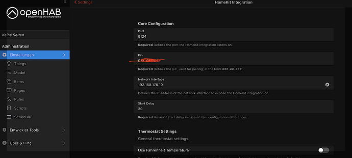

QR-Code not shown in homekit config in OH3
I upgraded to OH3. My homekit bridge wasn’t recognized after upgrade so I tried to re-add it via scanning the QR-code in OH config. The problem is, that the config screen does not show the required QR-code - it is just missing.

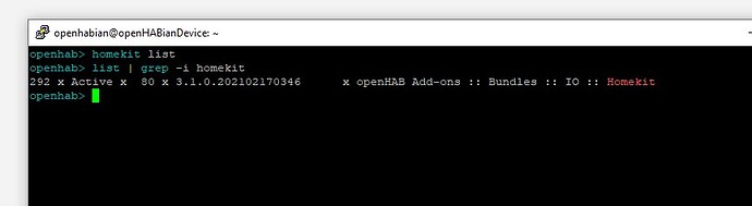

I have added some Homekit-metadata to some of my items, but nothing shows up in the Homekit App. Thus, I checked in the OpenHAB console - also there, nothing.
Then I found that while the the console tells me I am 3.1.0.202102170346 of the Homekit Binding, the OH3 UX shows I am still on 3.0.1 (which can’t be true, otherwise I wouldn’t have the QR code)

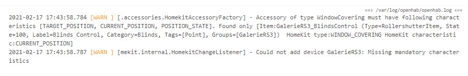

digging deeper,I found this in my events log. This item is a Fibaro Roller Shutter 3, and I have channels for blinds and lamella control. I added homekit-metadata to the item group (WindowsCovering) and underlying items (WindowsCovering.CurrentPosition and WindowsCovering.CurrentHorizontalTiltAngle), but have no glue where to add the required TARGET_POSITION and POSITION_STATE

add them to the same item as currentPosition.
Rollershutter type can handle currentPosition, currentPosition and position state
you can either add all 3 of them, e.g.
WindowsCovering.CurrentPosition, WindowsCovering.TargetPosition, WindowsCovering.PositionState
or you can just add WindowsCovering as tag to them item and it will get automatically considered for all mandatory attributes
so, you will have “WindowsCovering” at group and item.. looks maybe strange, but should work

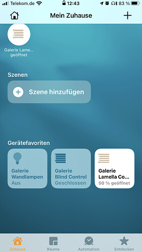

As explained, I have two items per roller shutter, one for the blinds control channel, another one for the lamella control channel. Both are part of a group for that roller shutter.
Initially, I had WindowsCovering as metadata on the group, I have now deleted that.

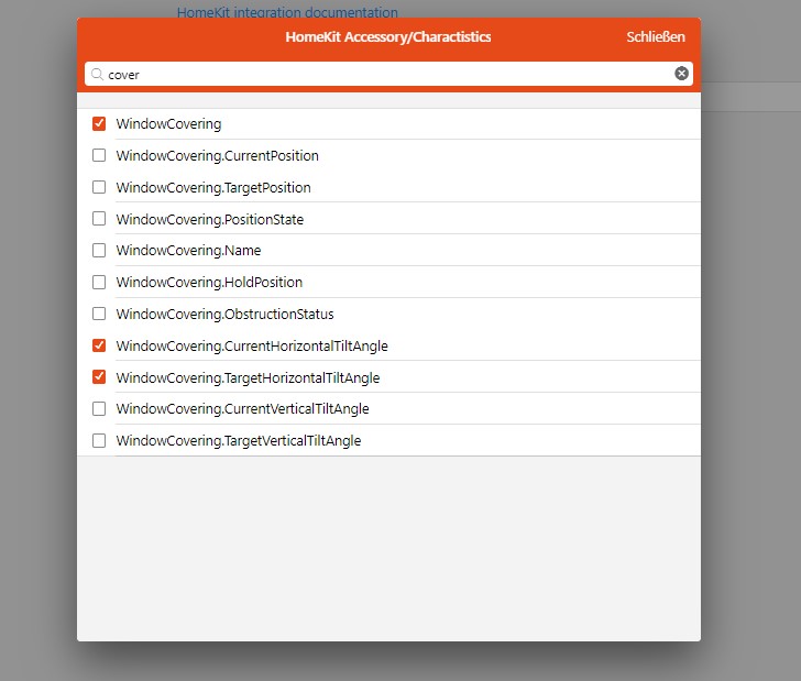

I added WindowsCovering, WindowsCovering.CurrentPosition, WindowsCovering.TargetPosition, WindowsCovering.PositionState and WindowsCovering.HoldPosition to the blinds channel item.
And I added once again WindowsCovering, plus WindowsCovering.CurrentHorizontalTiltAngle and WindowsCovering.TargetHorizonalTiltAngle to the lamella channel item.

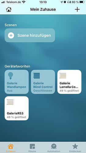

This results in two controls in Homekit, one for the blinds and one for the lamella, and both work just fine. So I am almost there.
My hope was I could have one Homekit control, that would then be able to control both the blinds plus the lamella, but it seems this is not possible?

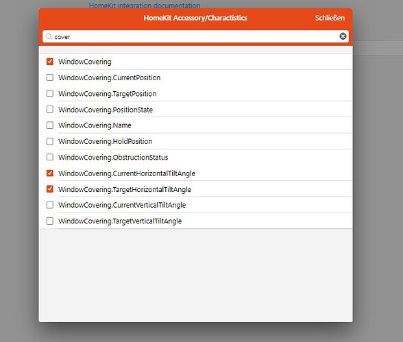

yes, almost there, you just need to put the group back.
here is the example in the text notation
Group           gBlind    			    "Blind with tilt"       						{homekit = "WindowCovering"}
Rollershutter   window_covering         "Blind"                         (gBlind)        {homekit = "WindowCovering"}
Dimmer          window_covering_htilt   "Blind horizontal tilt"         (gBlind)        {homekit = "WindowCovering.CurrentHorizontalTiltAngle, WindowCovering.TargetHorizontalTiltAngle"}
Dimmer          window_covering_vtilt   "Blind vertical tilt"           (gBlind)        {homekit = "WindowCovering.CurrentVerticalTiltAngle, WindowCovering.TargetVerticalTiltAngle"}
tried that; it only gives me another lamella control for the same thing
it looks like something is wrong group configuration.
with the config above i get one control - for blinds and lamella. but i have not tried to create it with UI
