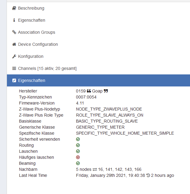

@DanielMalmgren: What firmware version do you have?
I got 4.11.
Another question: do you use S0 security? I actually do.

I actually don’t know. How do you know?
I use no security. I have no neighbours within radio range so it doesn’t feel necessary :sunglasses:
In Habmin, (mine is in German though)
or in Paper UI in the PROPERTIES of the Thing.
I’m on 3.0, so I have neither paperui nor habmin. I’ve searched in mainUI but no firmware version to be found there :frowning:
Qubino sent me firmware 4.1 and asked to not use S0 security during inclusion.
Up to now, the device works without issues. Knock on woods.
