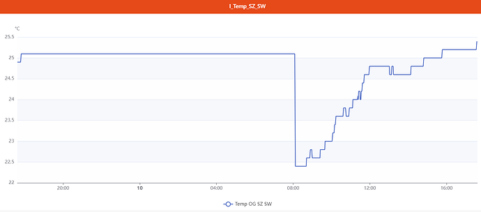

I have also attached a temperature sensor to all of them. It is not the original expensive one, but I have re-built it according to a friend’s advice.
So, I am able to see the temperature in the different rooms. But sometimes, a device just stops to send the temperature value. When I “Reinitialize the device” via the OH UI, it takes some time (probably until the diff threshold is reached) and the device sends the temperature values again.
Best way would be to solve the root cause. Do you have any idea what I have to check for the problem?
