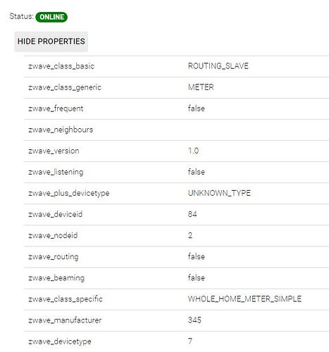

i just got an QUBINO 3 Phase Smart Meter.
I’m trying to include it in openhab, but it is found as " Z-Wave Node 2 (0159:0007:0054:1.0)" in Inbox.
In the Device Database there is an appropriate entry:
https://www.cd-jackson.com/index.php/zwave/zwave-device-database/zwave-device-list/devicesummary/900
The label of the smart meter says “ZMNHXD1”, there is a “1” in the name.
Manufacturer ID, Device Type and Device ID do match to the database entry.
What can i do to add the smart meter to openhab?
Unbenannt
Wow… that’s a heavy duty meter! Which version of the binding do you have? It looks like this was only recently added on 9/28.
I got binding-zwave - 2.3.0 - this could be the problem. Within the description of the binding the smart meter is not listed! Where can i get a newer version of the binding?
Wait for milestone M5 and upgrade to it, upgrade to a snapshot build, or manually download and install the binding from Cloudbees. If you choose the latter, this may be helpful (select snapshot, not development)…
Be aware of the recent breaking changes in the binding too…
Thank you, the smart meter is online now :grinning:
