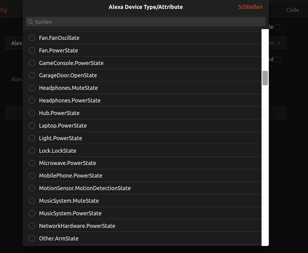

Have you set up Alexa-related metadata? → this is probably where the problem lies*
Are devices recognized by Alexa? → no
*see shortcut, which selection do I have to make for an Osram on/off/plug?
screenshot_2

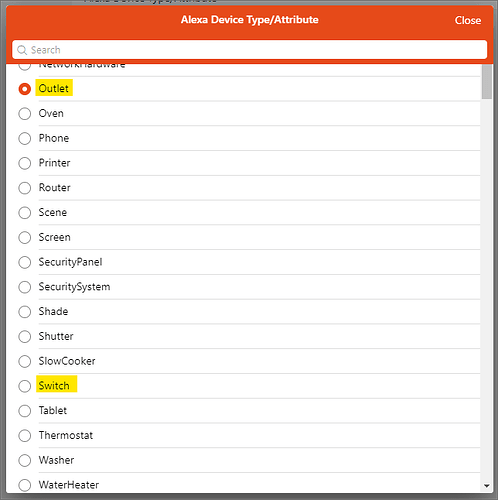

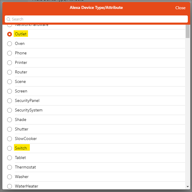

Per the documentation on Device Types, you’re looking for an “Outlet” or a “Switch”. However, I think “Light” (which you tried before) should also have worked. If none of these enable your plug to be discovered by Alexa then there’s something else happening.
