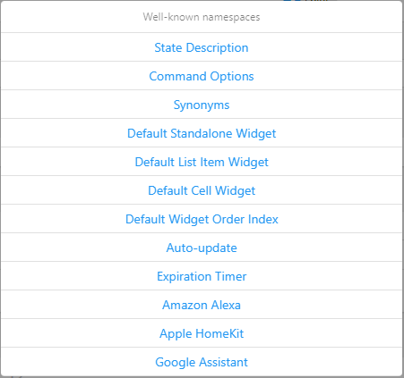

If you want to give voice commands to openHAB devices, you only need the smart skill. To use that, you just have to add metadata to your items. If you’re using text files for your items, follow the documentation. If you’re using MainUI, it’s third from the bottom in the metadata choices.

Most recently, I just installed Alexa Smart Home Skill and selected “Light” in the metadata of a lamp. The voice command was then not accepted. What am I doing wrong?

Adding the metadata tells openHAB that it should share the device with Alexa. I’m guessing that you now have to synchronize with your Alexa account so that it can see the device and control it. Maybe you do that in the Alexa app?
