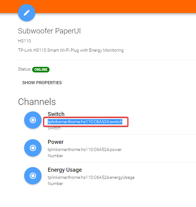

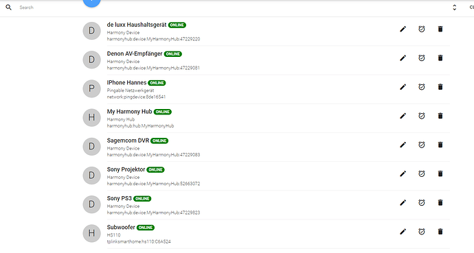

What I do want to achieve is:
Switch a TPLink Steckdose with my Harmony Elite using openhab2 (which is running on a synology ds918)
What I already achieved is that

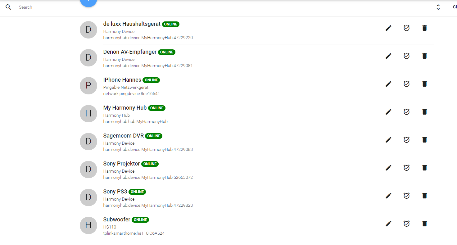

1.) HueEmulation Services running and recognized by Harmony Elite
2.) I can switch on and off the TPLink using openhab basic ui
3.) I can only switch off the TPLink using my harmony remote control.
What I want to achieve that I can either switch on AND off the TPLink using my harmony remote control.
What I noticed that I managed to switch on via harmony just once. Switching off and back on again DOES NOT work. I also repaired and resynced my harmony
What is causing the problem that I can switch on and off the TPLink using the basic ui but NOT via the harmony elite?

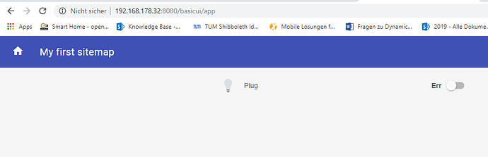

here is my default.sitemap
sitemap default label=“My first sitemap”
Switch item=Subwoofer label=“Plug”

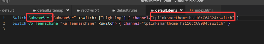

here my default.items
Switch Subwoofer “TPLink für Subwoofer” <light> (gWohnzimmer) [“Lighting”] { channel=“tplinksmarthome:hs110:C6A524:switch” }

Before you can proceed you need to fix that error:
Exception while formatting value ‘OFF’ of item Subwoofer with format ‘%.1f W’: f != java.lang.String
This error does not match your sitemap and item definition you posted, so the question is: did you configure some items via PaperUI instead of text files? You have a power channel linked to an item Subwoofer, but also a switch channel linked to an item Subwoofer. That won’t work, item names have to be unique. You are formatting a switch item with some %.1f W format. You don’t need a format at all for a switch item.

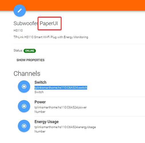

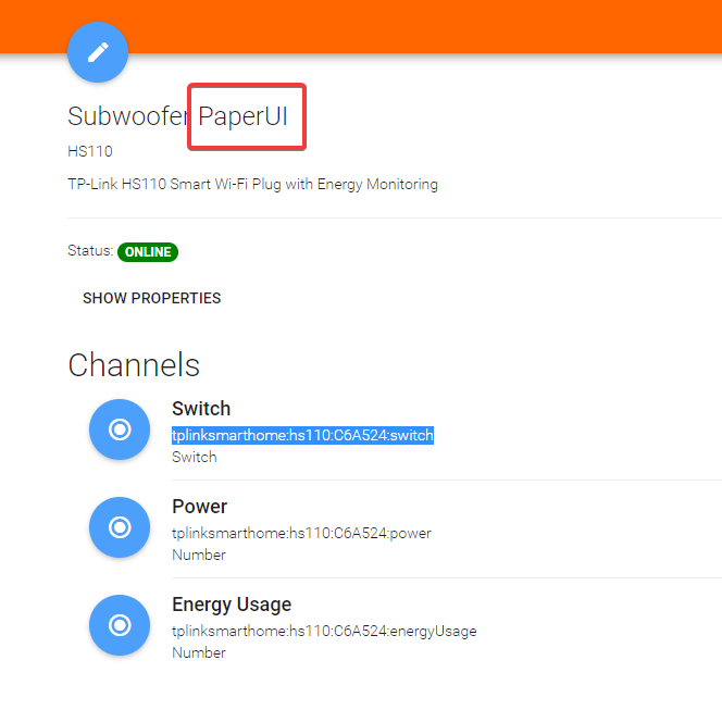

I changed the Subwoofer Thing by adding “Paper UI” to the name as follows:
I copied and pasted the info from there
to the switch definition in default.items as follows:
That should do the job.
Furthermore some other user pointed out to restart openhab and to clean the cache and the tmp files.
Then i renamed the switch as follows to check whether the changes have been forwarded to my harmony:
I see now the correct name Subwoofer2
Now I could switch on and off the TPLink… but only once. After that nothing works anymore.
Although I can use the basic ui to switch on and off perfectly it does work on the harmony just ONCE then never again?

No need for that. I was talking about Item names, not Thing names. You did not read the docs I linked to, I guess?
Yes, that is the correct way.
You changed the label of the item, not the item name. Please read the docs!

itemtype itemname "labeltext [stateformat]" <iconname> (group1, group2, ...) ["tag1", "tag2", ...] {bindingconfig}
Switch Subwoofer2 "Subwoofer2" ["Lighting"] { channel="tplinksmarthome:hs110:C6A524:switch" }
Switch is your itemtype, Subwoofer2 is your itemname, “Subwoofer2” is your item labeltext, “Lighting” is one of your tags, channel=“tplink…” is your bindingconfig.
