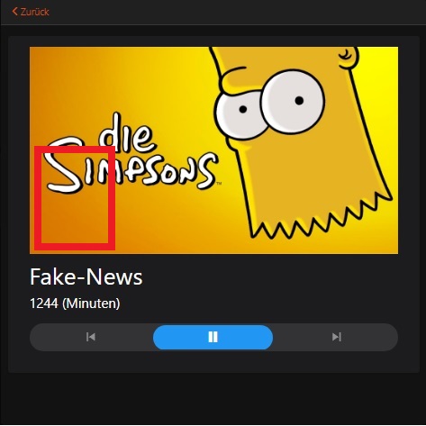

I try to show another small picture on the big picture, is that possible? the red rectangle.
and I try to display the running time, for that I have to divide the sec / 60.

Yes to both - you could encapsulate both images inside a f7-block and assigning absolute positioning to the 2nd image.
To work with calculations inside of widgets you could use the very basic javascript’esque implementation of the Math function.

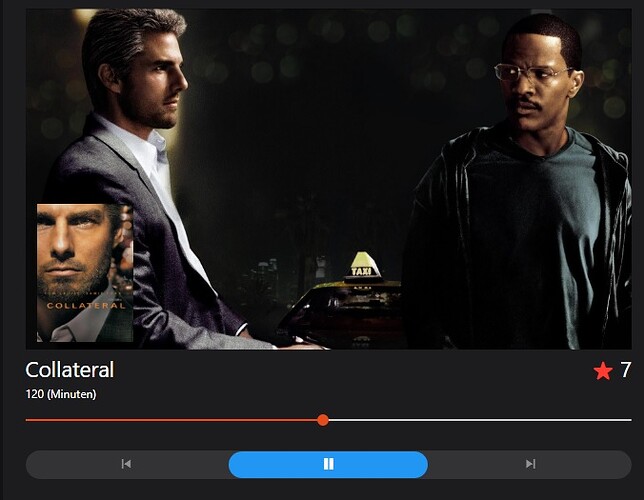

now i try da add a slider that shows me the progress, when i make a “slider-card” it works. but under my widget the slder dont moves.
have you a idea?

I tried to put a star icon directly in front of the 7 (f7-icon) on the screenshot, in the widget editor it is suitable but not when I open it on the mobile phone or on the overview page.
I think that’s because of the position. but i don’t know how to adjust them.
