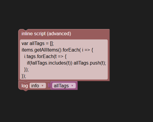

I get this error
Script execution of rule with UID 'ca832b5e94' failed: org.graalvm.polyglot.PolyglotException: TypeError: (intermediate value).getAllItems is not a function
Can you help me, whats wrong…
My mistake. It’s just getItems
items.getItems().forEach( i => {
