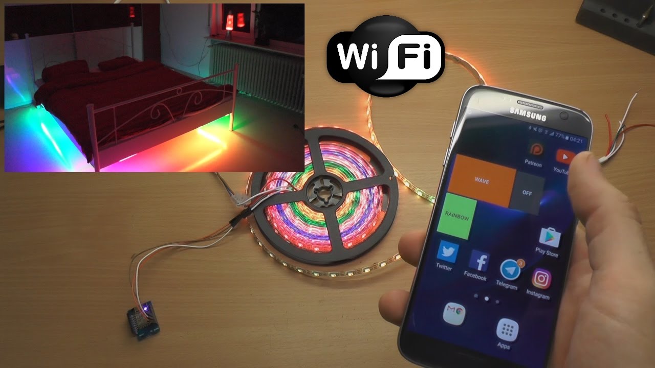

I have just been watching a few videos on YouTube about that topic
So you mean something like this?
Once setup it hosts a webserver and openhab would be able too send a request too that webserver changing the status of the strip
seems pretty simple actually if you plan on using the built in patterns/effects it would be alot easier too have a few videos too follow for guidance…
If I could get a addressable strip up and running standalone using its webserver I could always post here for help on integration with openhab and the strip
