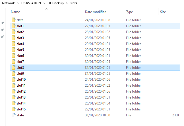

Hi again @mstormi hoping for a quick tip
I used Hyper-V snapshot today too restore my system too an earlier state set it too the 28th this month and need too recover my items and rules running the commands too get into my backups it lists the backups for the date the 28th how do i change too todays backups the 31st i have forgotten the command and cant find a reference on how too do this

it does say its set the dates too 31st but as you can see its listed backups for 28th but i definitely have copies stored for all dates not just the 28th

your right it does my bad but setting the date too the 31st still lists backups from the 28th
