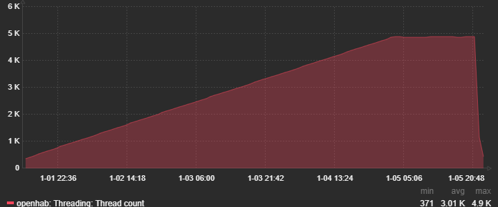

In Zabbix, it showed me that the threads are constantly climbing. Where you see the plateau on the below image is where I see the issues and the JVM is not able to create any more threads.
However, upon further research, I came to the conclusion that the number of threads is only limited by RAM, Heap size and CPU. Given that my RAM is only 20% used, my Heap size is only 15% used and my CPU avg is 4%, I didn’t think this would be a cause. My Java knowledge is rather sketchy too so I thought this may possibly be expected.

Like I say, it’s early days and I can’t say yet that the issue is fixed. I saw memory issues every 3-4 days but this is the impact on the thread count now that the Shelly Binding has been removed:
So it looks like the Shelly Binding is not disposing of threads correctly.
