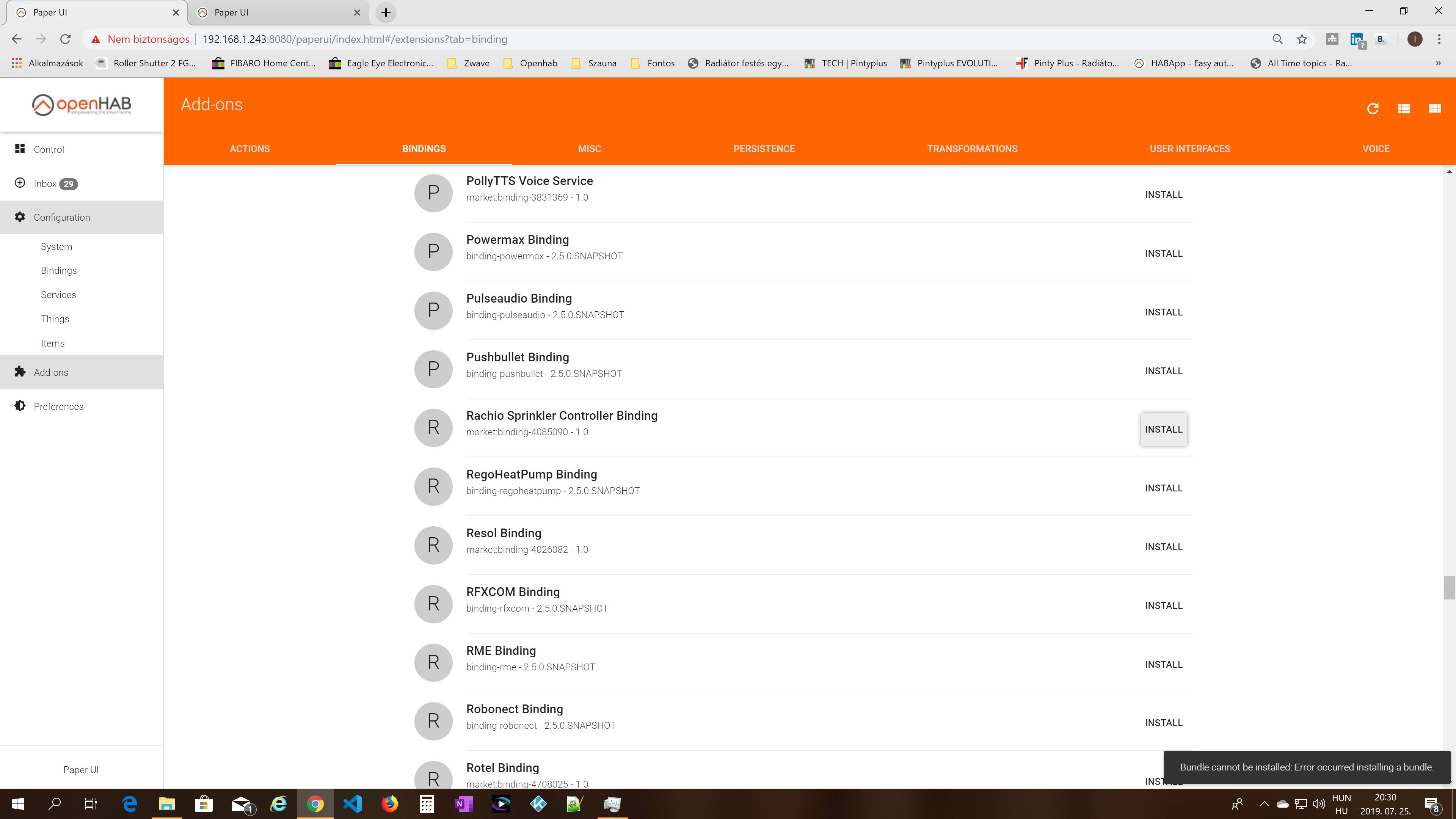

But after removing from addons and install marketplace I can’t install this binding. See screenshot about error message:

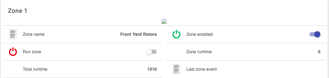

I am having a little trouble getting the zone image to pop up in my sitemap.
Item File
String   RachioZone1FrontYardRotorsImageUrl    "Zone image url"    {channel="rachio:zone:4575f4a5:009D6BBE5C92-1:imageUrl"}
Sitemap
Image    item=RachioZone1FrontYardRotorsImageUrl
I am not too familiar with images in sitemaps. Any ideas?
If I couldn’t get this working I could always get the direct image URL from the Rachio API but IDK how to do that.
Thanks!

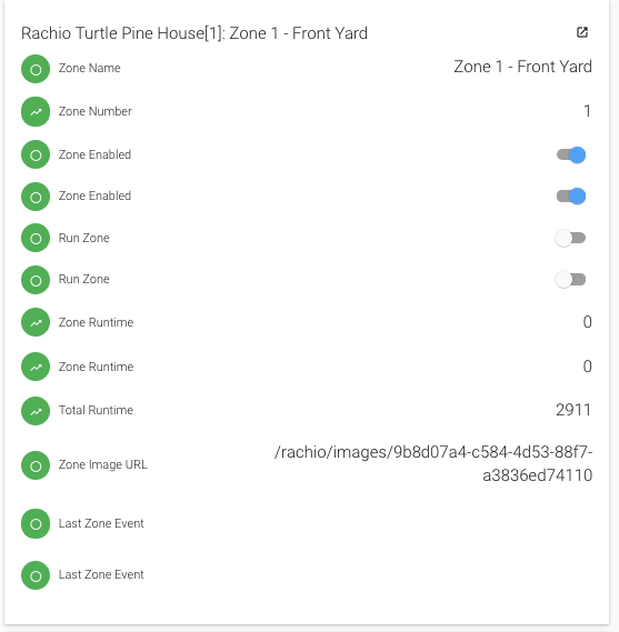

check PaperUI:Control if you get an image url. It should look like similar to this
Zone Image URL shows the url of the image. The binding redirects the image load to the local system, because Rachio had a format problem at some time (not setting the proper media type). You shoud be able to copy&paste this url in a browser: <oh-ip>:<oh-port><pasted url>. You should see the image in the browser.
You coud put the binding in to DEBUG mode to see the original and reqritten url.
Not without actual error from the logs. @kovacsi2899, what words do you see in the logs?
It works with sitemap. I’m on holiday but I try to check my code tonight.

Here is a screenshot of my sitemap if its helpful. The image is the first item on the page.
Nothing. Only this pop-up message is visible when I click on install button of Rachio Binding:
2019-08-11%20(4)
2019-08-11%20(2)
Now I installed 2.5.0_M2 and same result in case of Rachio binding. I can confirm that original jar file of the binding works when I put it into the addons folder. If you tell what debug shall I turn on I will make another try and extract the information. At the moment nothing is visible nor in openhab. log neither events.log files.

And the logs? That popup has no information. For any error you receive in openHAB, you need to look at and post the error that is printed to the logs.
As I told above:
At the moment nothing is visible nor in openhab.log neither events.log files.
you should have openhab.log even no binding was started. Usually you see an error on 404/503 errors in PaperUI
